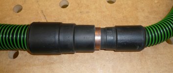

I made my own version that is pretty identical to the ones Bob makes.  One thing you may need is a 1-1/4" copper connector sleeve to tighten the connection between the 36mm hoes and the 27mm reduction whip.  Any of the big box stores carry the connector.

I think it's better to use a 18" (450mm) whip of 27mm hose than to try to couple a 36mm hose to the RO 90.  The 27mm whip gives far more flexibility than the 36mm hose.  The 1-1/4" copper coupling snugs up the connection between the 27mm hose end and the 36mm hose end quite nicely.
I get the logic, but that is way heavier and a lot more expensive.

I think the additional flexibility balances any additional cost.  The minor weight differential is inconsequential as I see it, and is suspended from the boom arm.
