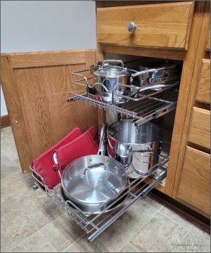

Rev A Shelf has a system now, I prefer the X-Series.Tom said “You’ll need to use X-series adjustable system”
The Rev-A-Shelf stuff was in the house when I bought it. That said, I think I'd prefer to have wood drawers rather than wire racks, Time will tell how much the wire racks annoy me.Tom said “You’ll need to use X-series adjustable system”
I think you’ll be okay with it, the wire systems work for pots and pans, for other items I prefer a shelf system.The Rev-A-Shelf stuff was in the house when I bought it. That said, I think I'd prefer to have wood drawers rather than wire racks, Time will tell how much the wire racks annoy me.
I tend to agree with you. I just have to adjust the top rack down ~2" or so.I think you’ll be okay with it, the wire systems work for pots and pans, for other items I prefer a shelf system.

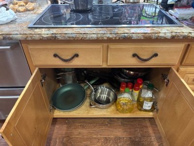

Actually my wife did specialty dessert and snack cooking (slices etc) in a restaurant our daughter owned for many years and a lot of it was done in our home kitchen.I take it you do not cook that much complex stuff in the kitchen. A drawer behind doors cannot be practically accessed while one of your hands is occupied. Unlike simple doors (no need to open both of them) or a simple drawer could.*)
If the pots and pans you put away are not entirely “cold” or not entirely dry from being washed, then the metal racks are superior. They allow more air circulation and the pots will dry without any damage or damage to the racks. Also, cast iron skillets are heavy enough to damage wood drawers.The Rev-A-Shelf stuff was in the house when I bought it. That said, I think I'd prefer to have wood drawers rather than wire racks, Time will tell how much the wire racks annoy me.
Good points. Thanks!If the pots and pans you put away are not entirely “cold” or not entirely dry from being washed, then the metal racks are superior. They allow more air circulation and the pots will dry without any damage or damage to the racks. Also, cast iron skillets are heavy enough to damage wood drawers.

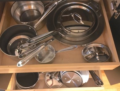

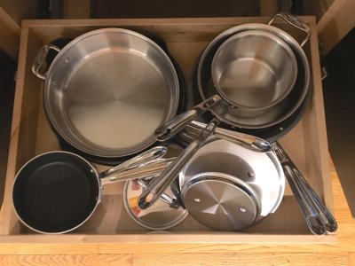

Mike, I just noticed the pots/pans that you want to store and they are very similar to what I store in our cabinet. Consequently, I've broken down the items that are stored in each drawer so you have a good idea as to what's possible. The inside dimensions of each drawer are 18 x 25 x 3-1/2. Covers & lids are kind of catch-as-catch-can...We are getting a stainless steel set. It has three fry pans 8/10/12 w/lids, three pots 2q/3q/8q w/lids, and so less used cookware - 12" wok, 7q saute, and 12" griddle. Probably most used are 8"/10" fry pans and 2q/3q pots. We have a 36" induction cooktop.

Check with your vendor of choice. All-Clad and Tramontina have models that work splendidly with induction. No doubt others will work just as well.will the stainless work with induction ?
You make a fair point about needing a real “home” for the pans once actual cooking starts. Leaving them on the cooktop only works until you need every burner.I find that the issue with "leaving most used stuff on the cooktop" is what you do with it when you actually need to cook using different stuff? Where do you put it? So you still need to have the shelf/drawer space for it, even if mostly left "waiting".
Sure, if you have a very big 40"+ cooktop with 6+ cooking zones it is likely some will be available as "storage" space at all times. Over here mostly 24" class cooktops are the thing though. Meaning that while the kettle could stay semi-permanently on it and be put only sideways. That is about it. Sure, a pot and a pan IS there mostly, but those still need "their place" for situations when real cooking starts .. and that place should be quickly accessible.
On another note, our plan for a new kitchen is to have three dual hobs instead of a single quad gas one as is the case today. A gas hob, an induction hob as the main ones and a cast-iron hob at the location there is just a put-aside space now. We figure the space is anyway "used" for placing pans and pots, so why not just "store/place" them on a cast iron hob that can be useful at times in its capacity and takes zero additional space, nor needs a consideration when placing stuff on, unlike the main gas and induction hobs do.
I find to have a blocked hand all the time /making dough by hand, cutting meat, holding something in it, whatever the cause/ so a one-handed operation for pulling the most-used stuff out is a must in my view.
*) That said, a face-less drawer in the form of a shelf on slides is probably not that bad an idea as the stuff on the front of it is still accessible without both doors opened. Rethinking it .. it is an excellent idea. Especially for an existing kitchen upgrade.
