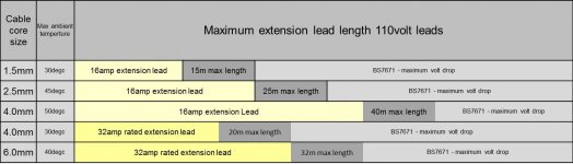

As the issue is voltage drop, and the voltage drop is lessened as the cable cross-sectional size increases, a "thicker" cable could help. The following is fromhttps://www.industrialextensionleads.co.uk/maximum-extension-lead-length-3-w.asp and provides some good information that might help you.
