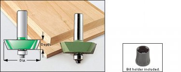

Hi Shaun,
For my shaker style doors I use Freud adjustable tongue and groove set, model # 99-036. Works great. If you want to put a profile on the inside of the panel you can use Lee Valley Shaker bit, product number 16J66.51.
Cheers,
JC
