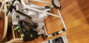

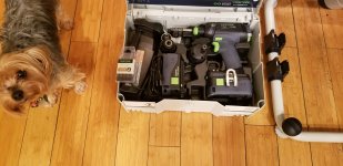

So here it is, got a nice surprise added to this wonderful gift a drill set too. [big grin][attachimg=1]
