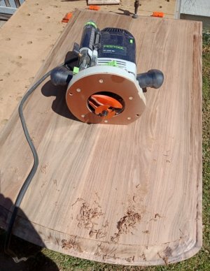

When I do small square or rectangular panels I usually use the router table, but larger ones and with a curved top one I last did I used the router freehand, as this was in Tasmanian Blackwood and took around 8 hours to CNC, so I didn't want any tearout stuffing it up. For me anyway controlling climb cuts on a router table while manhandling large panels is way more risky (and dangerous) than doing it freehand.
Despite it probably being the largest panel cutter CMT make, it was like a hot knife in butter, couldn't have gone more flawlessly! Aside from the amazing sheer power of it, the 2200 is so smooth and manoeuvrable it's beyond belief.
This is the panel in question, the dark bits aren't burnt areas, they're actually the darker grain showing through. You can see just how large the panel is compared to the MFT behind it!
Wow - beautiful work! With raised panel bits since you don’t use a fence do you hog it all off in one pass?
Thanks Mike! With the sections I climbed cut I took a few gentle swings at it, the rest was done in one pass once I realised how easily it machined despite being a hardwood. the cutter was huge, took up almost the entire router base opening. If I can find a pic I'll add it.

Well it took a while but I finally remembered to upload a pic of the huge CMT panel cutter in the OF2200. From memory it had 1-2mm clearance in the base.
Despite being so large and taking very aggressive cuts, it was unbelievably smooth. The OF2200 is just the most sensational router on the market to my mind. Incredible machine.

@Jim_in_PA To say I was packing bricks initially would be an understatement, but the sheer power and smooth balance made it trivial, it was akin to doing a shallow groove using a 1/2" diameter 2 flute in a trimmer.
I've been spoiled using the venerable ELU MOF177E's most of my life, but the OF2200 is just next level stuff on steroids.
The quality of the cutter definitely makes a huge difference too though, I don't think I'd tackle full depth with a cheap import cutter of that size.
