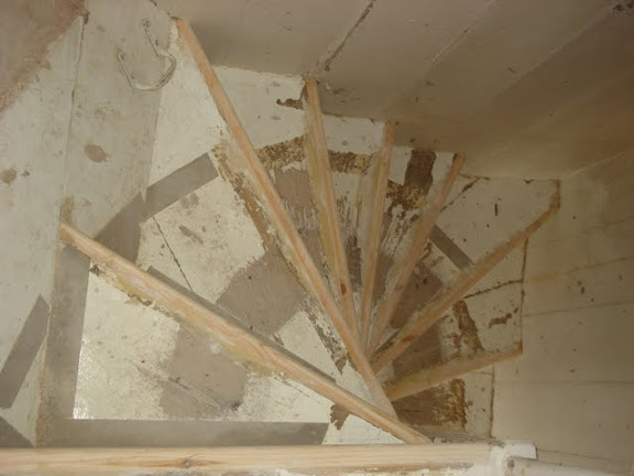

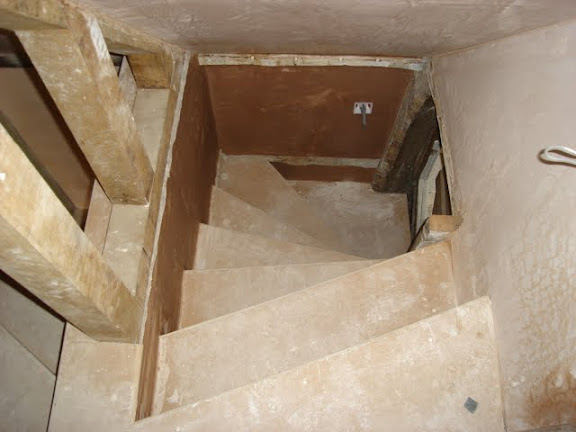

Existing 2nd floor stair.
2nd floor side stair, what was left of it!
1st floor stair.
1st floor side stair. (with temporary fix)
So this was my start point.

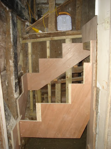

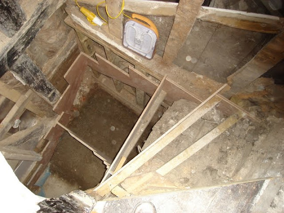

Plywood framing for 1st floor stair.

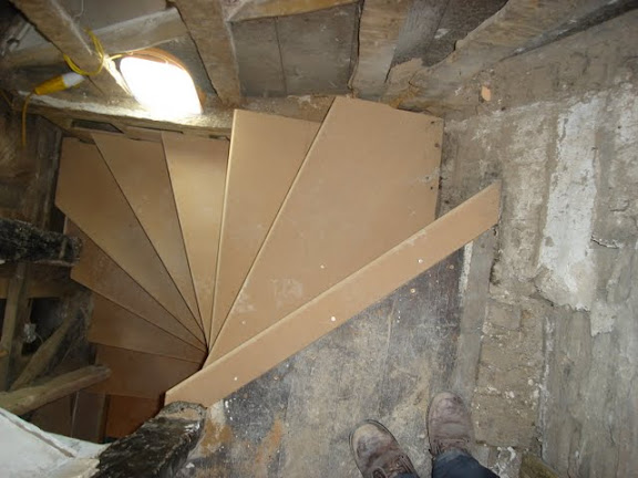

We're taking steps!

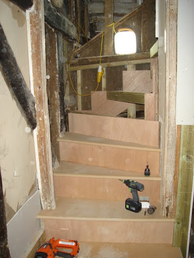

2nd floor stair underway, had to install a new newel when the existing one came off in the clients hand as I was telling him it was not fit for purpose! ;D
Better than Celcon blocks.

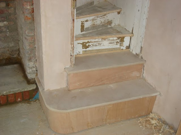

1st%20Floor%20Side%20Stair%20With%20New%20Bottom%20Steps%20%26%20Replacement%20Nosings.jpg

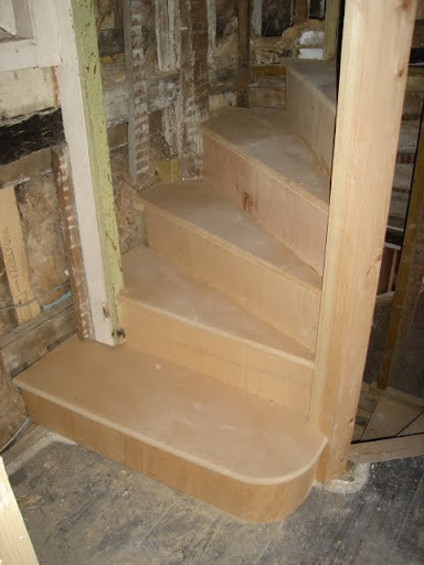

New nosings installed.

Nice work and sure challenging to complete. Even in this bad economy I would have turned this one down. Did you use plywood for the stringers (US term for the members that hold up the treads and risers) and MDF for the treads?

Brice- 3/4" ply for some stringers and stud work for the areas where I could install it. 1/2" ply risers and 1" mdf for treads. Got the idea from "Carpentry" by Gaspar Lewis which I found while in Forida 14 yrs ago.
