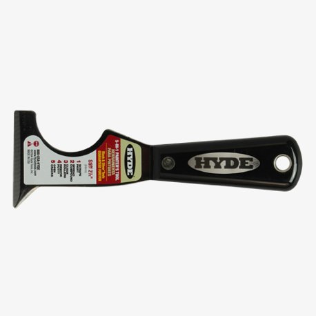

About 15 years ago, I affixed a soap dispenser to a bathroom wall using silicone adhesive.  The dispenser just died.  I will be using freestanding dispensers going forward.
I was able to pry the dispenser from the wall using my 5-in-one tool.
A heat gun and that same tool allowed me to remove all but a few thousandth’s of an inch of the stuff.
Acetone, alcohol and mineral spirits afforded no help.
Any suggestions on how to get rid of the remaining adhesive?
