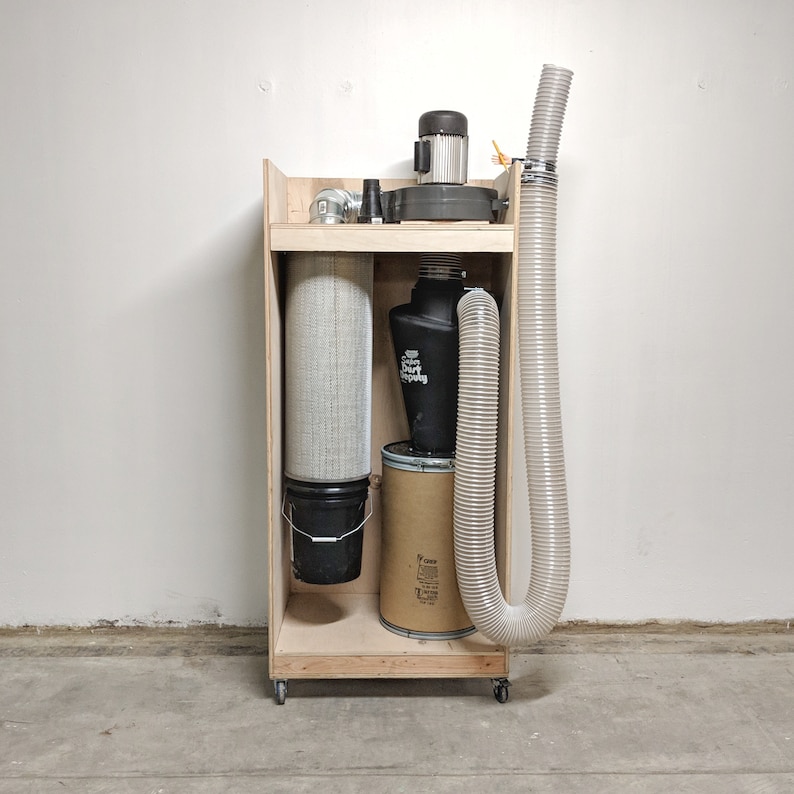

I have the dust right and it feels a bit underpowered.  I've been struggling with how to set up my dust collection.  I built a cabinet for the dust right and trash can separator.  That isn't working for me, space wise.
Finally someone showed me this and I bought the plans.  I finally decided to convert my dustright to this cart.  Then, once I learn how the cart is built, I'll build a second one with a Harbor Freight, as shown in the plans.  :)
