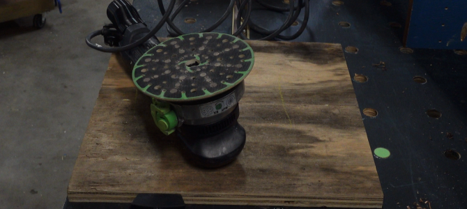

About a month or so ago, I picked up a used RO 150 E (the one with the green Rotex switch on the side above the sanding pad) and I finally got to try using it today. As expected, it's an aggressive sander but is spewing dust everywhere. I thought that was odd so I pulled the abrasive off, turned on the vac and put my hand by the pad - I could sense no suction.
Could there be a blockage along the extraction pathway? Or does the sander have an internal blower? What should I check on this sander? Thanks!

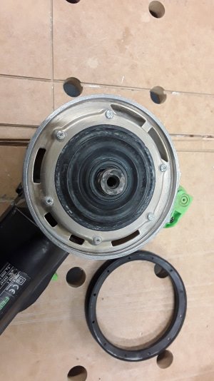

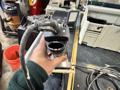

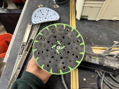

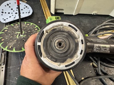

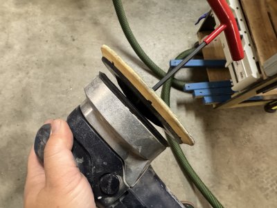

I thought I would take some pics for this thread and got to looking at it and have found the issue. Checked the tube with a light and all looks clear. Put the MIDI hose on it at full and you could hear it pulling. Just not at the pad. Unbolted the pad (it’s the same as the ETS EC 150) and the suction pulled well through the body ports.
Put it back together, connected the hose and turned it on again. I could hear the suction pulling strongly and could hear it coming from the vicinity of the pad. But no suction at the pad.
I’m guessing there’s supposed to be some sort of boot surrounding the pad?
It’s sucking. Very well. But only as a halo around the pad!
It still sands like a beast though.

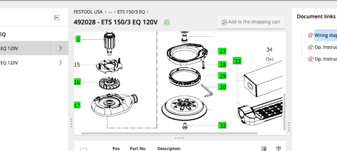

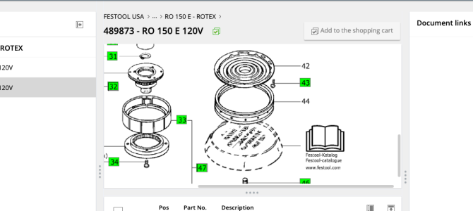

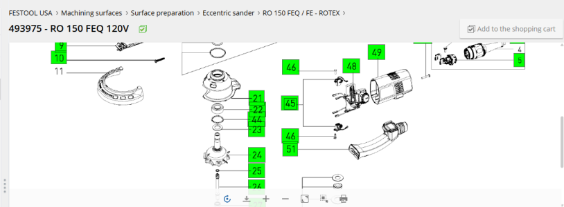

Looking through EKAT, it looks like the missing part is no longer available. Might anyone know of any dealer that has this part lying around? EKAT USA has deleted the part number. I was thinking about ordering the FEQ part that seems to be similar. Probably will not work but it looks like it's $8.50 so it might be worth trying out.
Then there's the collar from the ETS 150, leaving me to wonder if the 150 pad works on the RO150E then perhaps this one might work too?
Any thoughts?

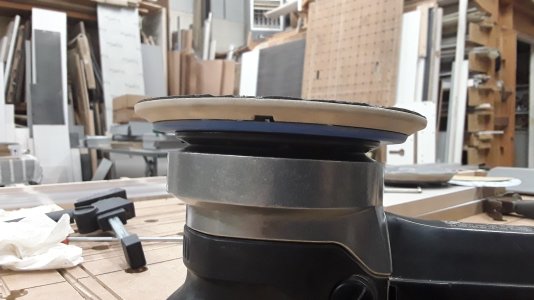

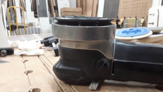

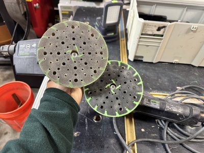

I have to say, the profile of the velcro pad that is fitted to your 150 E doesn't look like the pads that I've got for my 150 E from memory....?
The gap between the body of the sander and the underside of the pad on yours, looks much bigger than on mine.
I'm going to my workshop this morning, so will take a more detailed look at mine and take a couple of pictures.
Maybe, yours is indeed missing the rubber seal that fills that void?
I have the original " Soft" pad and a much newer "Hard" pad, that I was led to believe are specific to the 150 E model.

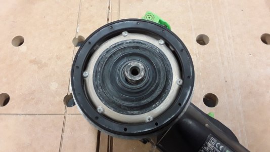

Here are a couple of pictures of mine.....
Looking at your picture 5 in your post #13 above, I'm wondering if someone has replaced the black seal at some point,.....and fitted it incorrectly...?
It appears to be there on yours, but on mine, it is a snug fit in the rebate between the steel plate that is held in position by the 6 screws ( 5 screws on yours, as it looks as though one is missing...) and the back of the sanding pad.....It is not held in position by the metal plate at all.....It just pops out when pulled.
Edit......Comparing my photos with yours, it appears as though your metal plate may well have been fitted upside down as well....!!!???
The heads of the screws on mine protrude above the plate, not recessed in.
Try removing the metal plate and turn it up the other way as per mine and reassemble with the black seal as shown in my pictures....👍
Hopefully, the seal will still fit if it hasn't been damaged or is now mis-shapened.....
