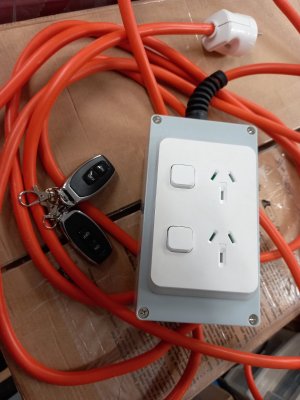

I have a power point on a 433 mhz remote on/off switch. I can manually turn on /off the system with the remote fob. Or can have it set for the tool to start / stop the vacuum. Now that I have the fob near the machine / tool I am using , have found this to be a good solution for 1 vacumm. I can have the 2 Festool hoses connected at the same time, on on the machine, and the other for local clean out/clean up. I can also switch the outlet from the 2 Festool hoses, to the ducted layout in the shop next door. Then plug in the Festool hoses from the outlets. Uncap and plug in. Fob the start or stop as I go. They have about a 30m range or so. I have another box power point on an extension cord with the 433mhz remote as well.
I call it the remote extension cord. Between the 2 of them is very handy. They can be on their own Fuse circuit of the workshops.
When installed in the wall, it needs a cover plate and access to the led and the setting button of the remote unit.
My vac system is on wheels and has a 50L catch drum with a Cyclone on top with a Y out let. So can follow around all of the 2 shops. Or can be parked by the ducted system.
Pic of the remote extension cord.
The 433mhz solenoid switches I got, are intended for single phase water pump motors etc, are rated for peak 30amps 220v and constant use of 10amp/2.5kw Cheaper ones are only 25amp peak, and less than 1kw constant use. Their examples for the cheaper ones are for lights, or used for garage door openers etc Not industrial motors or constant use loads above 1 kw.
Edit update, I re checked the place and data for my Remotes. They are only rated for continuous use at 2.5kw max. If 3 kw is required, then a higher capacity relay switch is required. The 30amp peak is to allow for start up loads of water pump motors.
