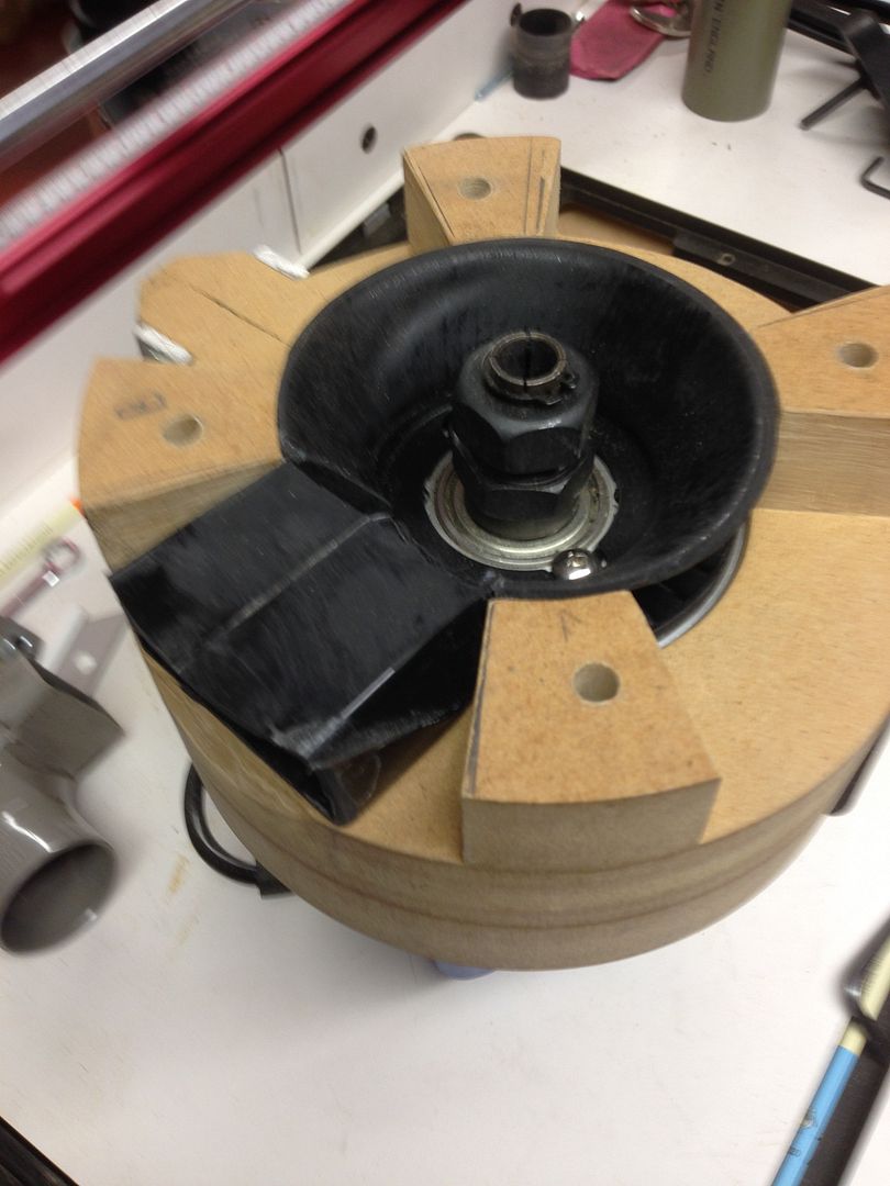

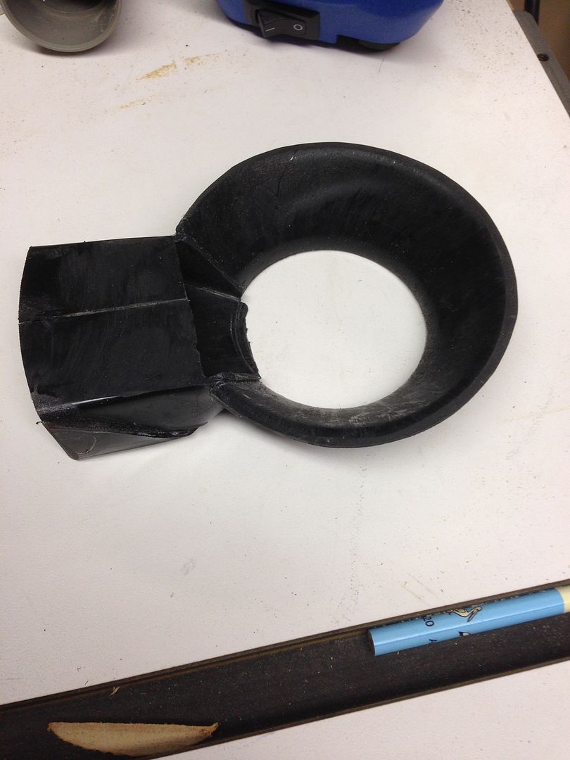

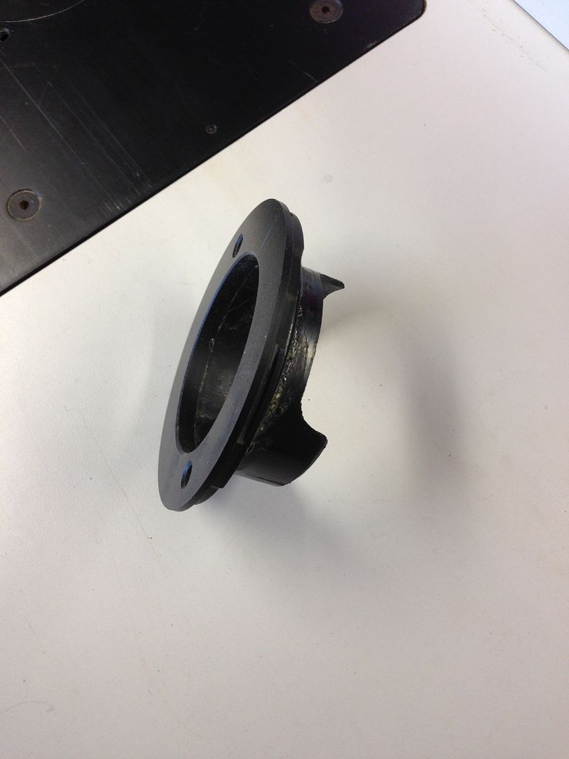

The next problem was how to provide for the cooling airflow from the motor as well as good dust extraction and access to the collet nuts etc.  As the pictures show, the cooling airflow comes out of the vent at the cutter end of the motor; it is a pretty strong airflow when running at full speed.  I did this by making a cone shaped deflector through which I have fashioned an extraction chute.

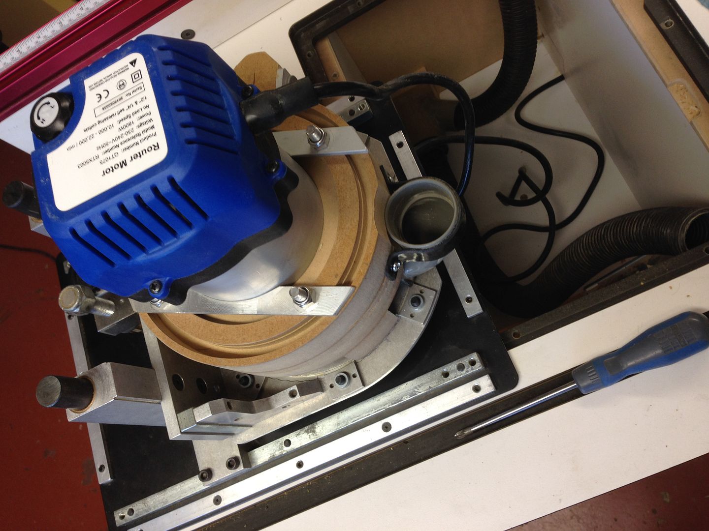

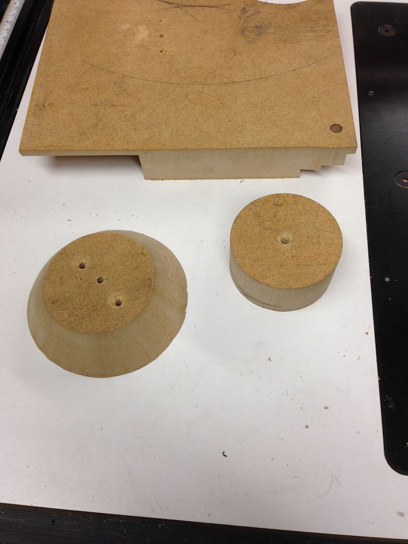

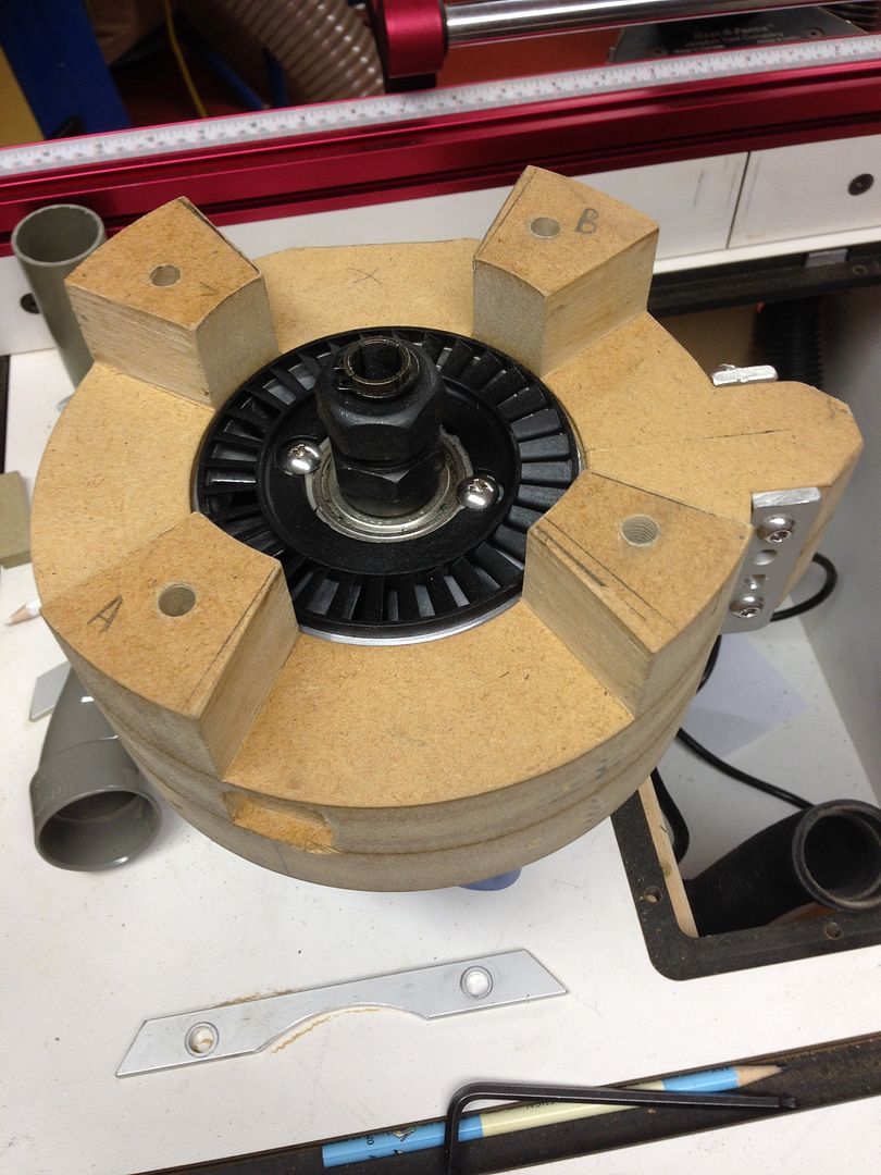

The collar was made out of three thicknesses of 30mm mdf glued together.  The circles were cut out as far as possible with the OF1010 then with a bearing guided cutter using the existing router table (yes, you need one to make one…, although alternative methods exist). This was a loose fit over the motor body and then a bandsaw cut made in the projecting wings on the collar; this enables the collar to be clamped tight around the body.

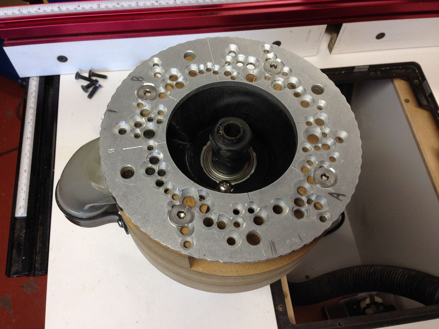

I cut out sections on the top to allow for airflow from the motor and the extraction chute – just had to spend a few ££ on some M8 countersunk bolts to fix the Rout-r-Lift plate (screws might have been ok, but the remaining mdf was potentially weak where I had cut out and I wanted to bolt it tight – I had some strips of aluminium that very handily had a part circular cut out that just about fitted the circumference of the motor body – these I used for clamping bars.

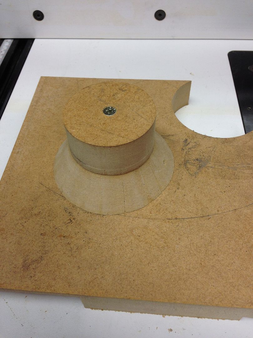

The conical deflector was made by softening some plastic rainwater downpipe over a former (made mostly with said circle cutter) and the dust extraction chute and elbow was fashioned by softening and shaping another bit of pipe and a 40mm drainage elbow – this was a bit of a faff, but once done, works very well.

The collar fitted and clamped:
The cone former:
The cone deflector and chute - unfinished (next time a 3D printer job I think...)
The assembled deflector and chute in position:
Bolted to mounting plate:
Mounted on Rout-r-Lift:

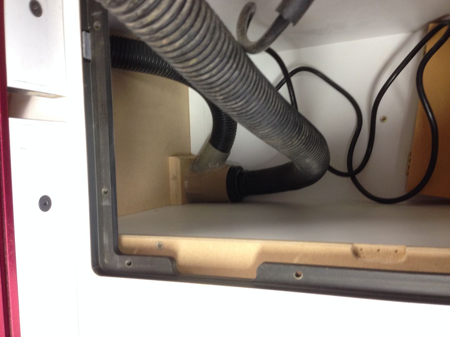

Dust extraction hose connections (one hose to the router the other to the back of the fence; Y-connector made up from sundry bits of pipe ages ago):
The finished article:

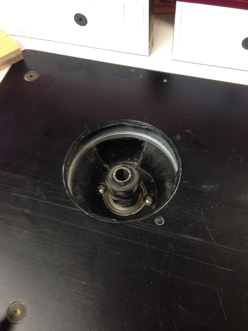

The router plate inserts are supplied flat - I glued on a funnel to the underside of each insert with a cut out to guide the chips to the extraction chute:
It all seems to work rather well and I have struggled thus far to find a combination of positions that deposits any chipping/dust in the space below the router, so the dust extraction is definitely superior to what i had before.
