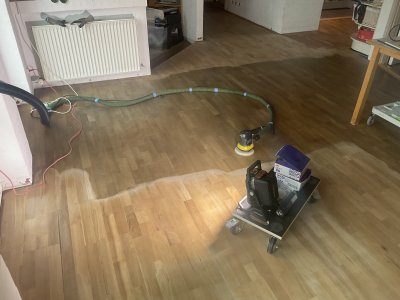

I recently sanded around 30 square meter of living room floor with a RTS 150/5. It did not take long to realize that I spent too much time on my knees. And too much time getting up to fetch stuff, which I had left behind, now out of reach.
So I sat down on a SYS-RB instead, put all my other gear on a wheel board, and did the rest of sanding on my ass. That worked well.

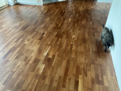

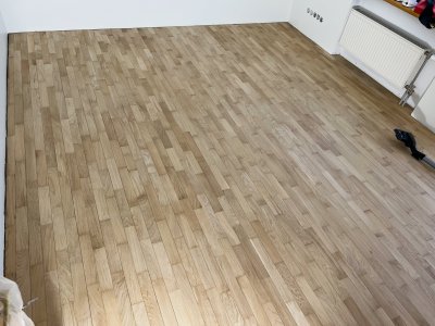

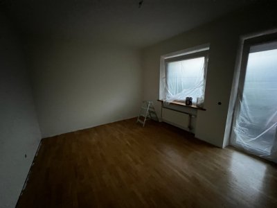

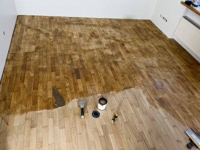

I've done that once for a pretty small (like 15m²) room that had a lacquered oak parquet using RO150. I was really happy with the outcome as this was my spare time project, but next time I would probably rent a dedicated tool for that (those big belt sanders) that would make the job way faster and most likely at a better quality.
I have started with P40 to remove old lacquer and to perform initial leveling. Went up to P180, I believe.
Having BG-RO 150 attached really made handling easier. And I have used high-quality knee pads, as you're going to spend plenty of time on your knees. Other than that, the process was pretty straightforward.

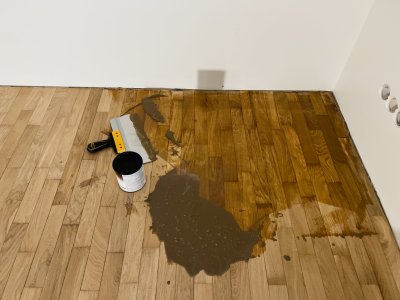

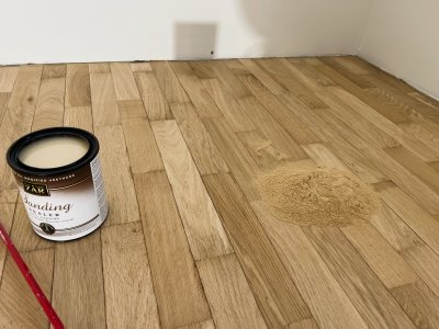

P.S. I highly recommend switching to a new empty bag once reaching a "clean" wood. Dust mixed with a sanding sealer is a great thing to fill all spaces and cracks, if there are any.
Good job on the floor especially using just the RO 150. :)

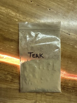

When I've refinished oak & maple floors, I saved a bag of sawdust for that express purpose. The same happens when I sand teak furniture, although I don't need to save nearly as much saw dust because it's usually used for repairs rather than filling.
Common hardwood sawdust reserve makes sense 👍🏻
