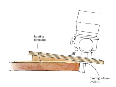

You could make a simple jig like the attached pic I found for the router with a long 2 flute straight cutter (or dovetail) to achieve a bevelled edge.

Or even use a smaller vee bit with a template that you move inwards as the cutter moves up, so you get a clean sweeping angle that looks like it was cut in one pass.

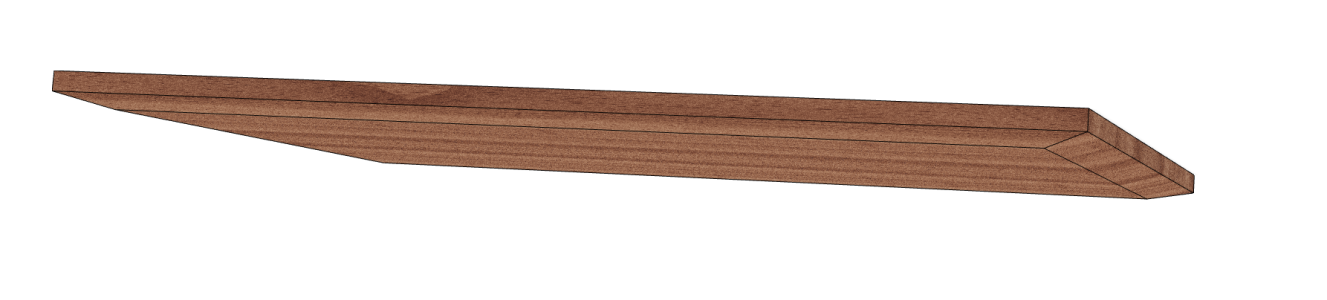

I don't want to mess with the edge, which is the "live natural edge," I want to bevel the underside. If the table were square, it'd look like this:

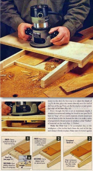

Sorry I should have elaborated, you could do it from the top at an acute angle or from underneath depending on cutter size. What might be far simpler though is to flip it upside down on the bench, and create a ramp jig matching the angle you want with a slot big enough for a template guide, and use the bottom of a wide cutter to machine it in passes from the underneath sliding the ramp jig sideways to complete it. I'll see if I can find a pic that illustrates this.

Yeah, I was thinking along those lines myself, but the live edge complicates things. The first photo's jig indexes against the edge of the table, which obviously wouldn't work. The second jig could work, but it would have to be over 5' long since that's the length of the table. And that means supports that won't bend when not supported over that whole length.
So yeah, doable, but somewhat involved.

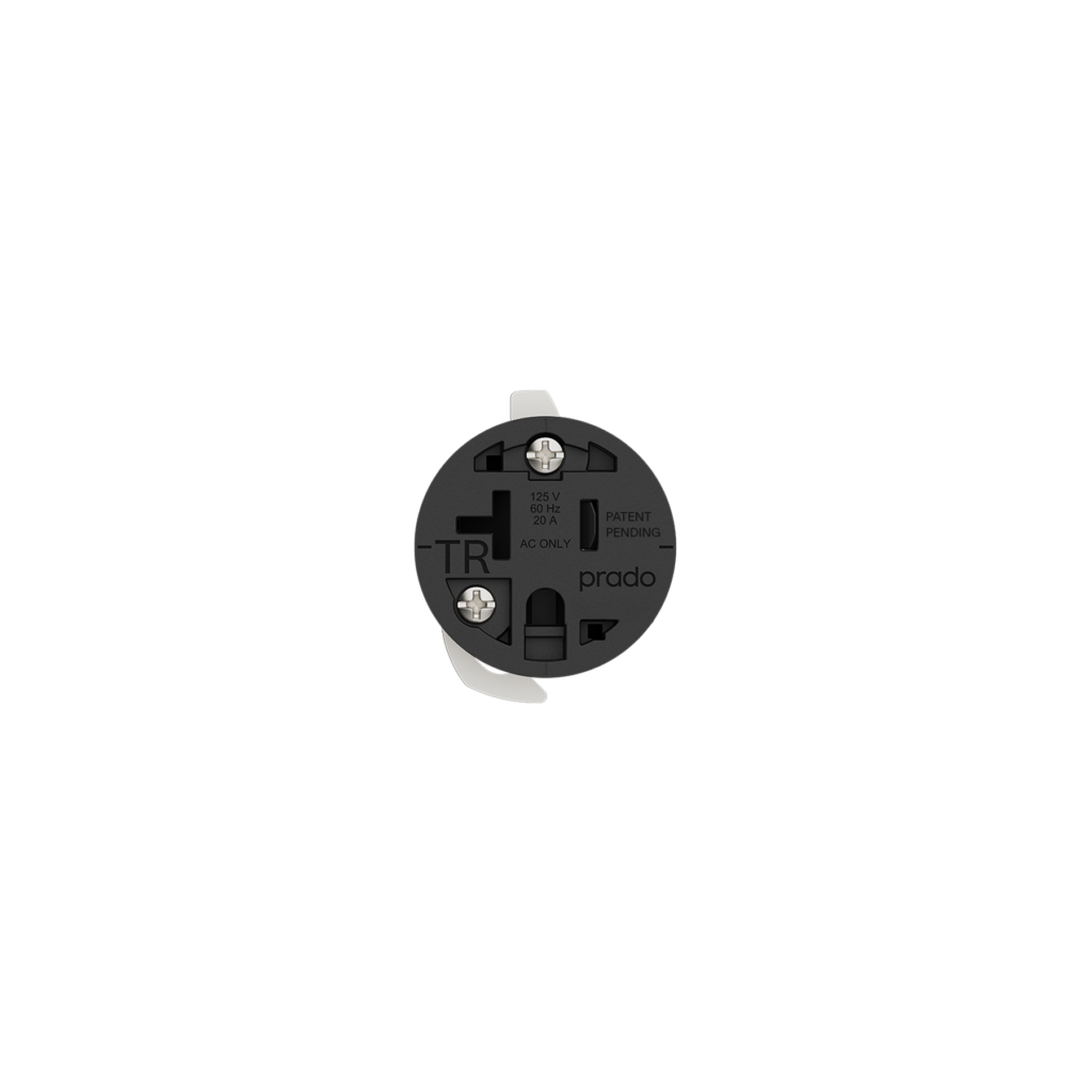

Just saw this sleek compact outlet, which comes in a few versions. This one has a cord so suitable for inlaying into a desk (fits in a 35mm hole):
I love the mounting design, very nice!

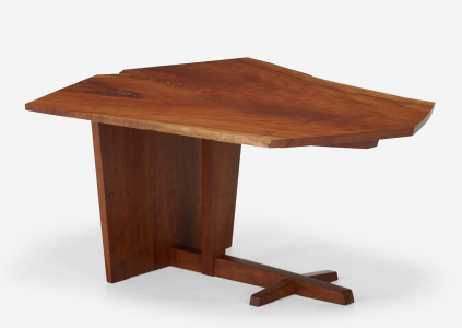

What I'm trying now is that little cross leg, as shown in the Nakashima desk above. But, interestingly, on the desk whose design inspired mine, he doesn't have that cross-leg. Then again, his top isn't as wide as mine. I'm certain that the joints I've built in the prototype are solid and that there's no movement there - it really is a torsional twist in that bottom stretcher. I'm thinking/hoping the cross-member will plant the "far" end of the stretcher firmly on the floor and with the weight of the desk holding it down, that will prevent twisting.
If not, I'll have to judge how much it improves and decide whether the cherry will add enough rigidity. Or, go for a different design, which would probably be a smaller-scale slab leg at the far end instead of that angled upright. One issue I have is that I'm working with two slabs from the same cherry tree, one for the top and the other cut up for the base, so I don't want to mess the base up and then have to find other cherry boards that kinda match color and grain-wise. I suppose I could splurge on some other cherry and build a prototype from that....

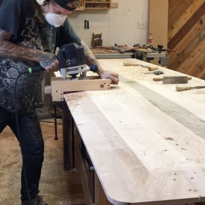

Separately, I talked about this before, but the slab is about 1&15/16" thick and we want it more like 1&⅛" thick. One my local hardwood suppliers has a one of those manual CNC things - basically a big router on a table gantry. They can take it down for me at $150/hour and think to do just one side will be under an hour. So, outside of the hassle of getting it down there and coming back to pick it up, I think that's going to be better than building a router sled and taking it down in my shop. But maybe someone could convince me otherwise?

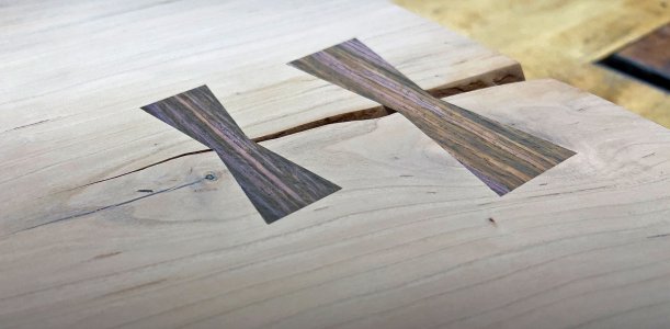

I've got the base all cut, except for whatever decorative treatments, so am looking at the top again.
I don't see how a butterfly is going to work, now I've looked more closely. Essentially, I've got this peninsula-shaped piece. If I cut through it, then the side that isn't supported falls away. If I position the butterfly to cover the whole peninsula, then it looks weird/off.
So, I think I need to either epoxy fill it, or cut away enough of the peninsula that what remains is strong enough to be left alone. I'm not so worried about having a bigger gap/hole, I just want the hole to look good.
I hate it, but I think I need to fill it with epoxy. Now, clear or black or some other color?

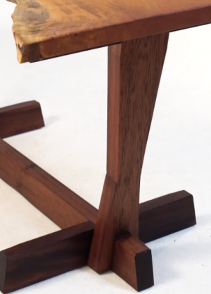

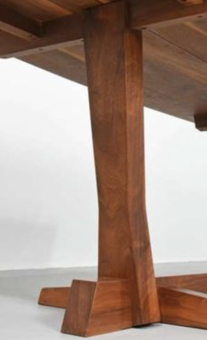

On the decorative treatment I mentioned above, right now the angled leg is rectangular in cross-section. On Nakashima's Conoid tables with splayed legs, he brought in the sides in kind of a straight-edge hour-glass shape:
Another angle:
Now, my single leg is angled further (25º), but it's the same basic idea with the bridle joint at the bottom stretcher.
Any thoughts on this, or perhaps some other shape?
I do want to keep the leg full cross-section at both top and bottom for structural reasons, but the leg itself is 45mm thick by 100mm across, which has got to be more than plenty in this application, so there's room to cut away for something more pleasing.

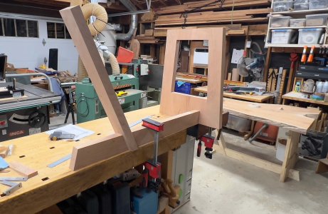

Here's a photo of the dry fit before the leg was cut to length and an angled top plate added:
I could also add/modify the trapezoidal main base at the other end of the stretcher.
Note the concept here is to have a very geometrical base to contrast and emphasize the live-edged top.
I think that you need a foot at the end by the angled leg. At 90 degree to the long base piece and long enough to help to help your long base arm resist twisting.
Yeah, I ran into exactly that on my prototype, and explored adding the foot here:
The foot didn't really help there. What I saw on my prototype was construction inaccuracies led to the top of the leg not being parallel to the bottom of the top, so essentially it was a single point contact - and not glued/screwed. And my prototype is pine, not stronger cherry.
But, that's why I added the 160mm square piece to the top of the angled leg, as I showed here:
The foot needs enough weight pushing down on it to matter, and needs to be accurately milled and placed. At this point I'm going to go with the added top plate only. If that's not stable enough I can add the foot afterwards to the glued-up base assembly.

Oh, and he under-beveled the top to make it look thinner as well.

Got the butterflies (bowties?) cut and installed:
Now to flip the top over and do any fills/repairs there, then figure out the thinning.
