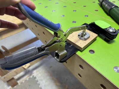

So, got my Seneca XL plate. Seems really nice, but with the Kreg clamp installed, I'm unable to clamp it down on even a 5/8" piece of wood. Lever is too high, too much force needed, no matter how I adjust it.
What am I missing here? This is the 3" clamp.
I just finished a project where I used mine a lot. I do find that it auto adjusts better if I open it all the way open before closing it. I assume you have adjusted the tension knob (shown in your picture) toward the "-".
Bob
Bob
yeah, tried that.
After watching some videos on it in use, I can see that mechanism that makes it auto adjust (into which is the adjustment screw) IS NOT moving at all.
I think this video is exactly the issue. Will wait to hear back from Woodcraft before I attempt to fix it myself. Seems like a QA problem at Kreg assembly plant.
