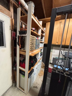

Got tired of the stacking game and finally did something about it.
I was able to use reclaimed or ultra-cheap materials:
The next day I was frustrated with “Where do I put these screws? Can I just open a systainer and grab something from it?”
So I installed a pull-out shelf that slides on wood runners. That was a tip learned from Sedge’s garage shop. The pull-out shelf closes flush — I had forgotten to shove it all the way back in the photo.

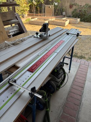

The LR32 kit was used for the shelf pin holes. This time I made the length of the verticals to be a multiple of 32mm — it’s such a delight to have balanced boards for the snug fit between the LR32 spacers.

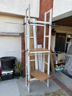

It’s a pleasure to do clamping with the Sash Clamps. The F-clamps are awkward and heavier in comparison.
I could not find the Betterley Alignment Tool. So I used the Woodpeckers 36” Straight Edge to check for any wobble on the rib of the combined LR32 tracks. A wood block with a rubber mallet helped to get the tracks aligned.
A few days later, found the Betterley Alignment Tool a few days later sitting on table of the unused scroll saw.

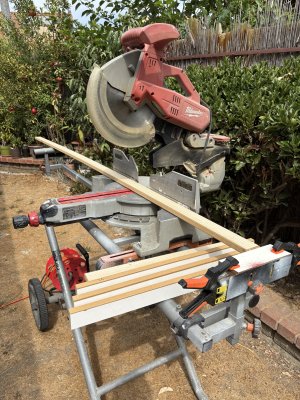

On the Miter Saw, I found a random scrap block for the Stop Block. However, squint to see the 1mm yellow shim for that just right measurement. The extension on that side of the Cart is frozen — it does not move. Someday I will fix it.

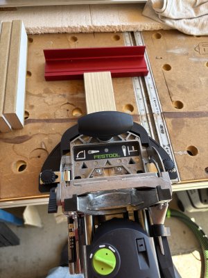

Face Mortises are so much easier with the TSO Bigfoot. I have much more confidence in the placement and stability of the Domino when using the Bigfoot. However because of the weight and awkwardness, I don’t use the Bigfoot when doing edge mortises.
End Mortises into the Rails were done by using the Trim Stop accessory. That saves a lot of time and it’s so much easier than aligning to a pencil line.
I should’ve reversed the width of the mortises. The MDF rails had Medium width end mortises. The plywood uprights had Tight width face mortises. I now realize for strength, the MDF narrow rails should receive Tight width end mortises.
