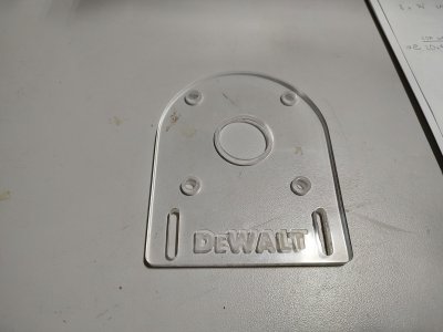

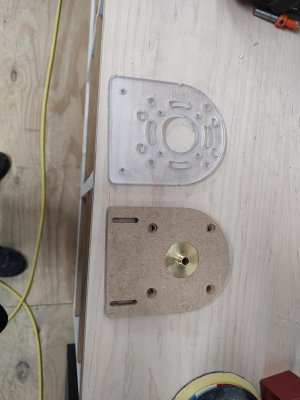

I had a meeting at the old shop a couple of weeks ago, and my former apprentice was in need of a sub base that could hold a Poter Cable bushing. I took a few measurements and essentially duplicated the original, just the opening.
He had come up with the idea of a couple of holes, to screw a small edge guide to it. I modified that into slots.
Prototyped an MDF version to test fitment, then acrylic final, with some flair. why not

The base plate is kind of weird - there are 4 mounting screws and they're in a square pattern but they look random since they're not aligned with the straight edge of the base, nor the posts. AND, the center hole is teardrop shaped so that the suction through the non-locking post can work. I spent some time today taking measurements and mocking up a base plate configuration. First use will be in a router sled - it'll be interesting to see how well/poorly the through the post collection works with a ton of sawdust being created.
