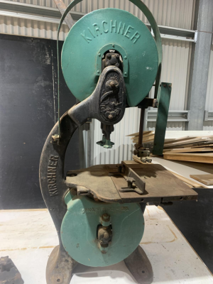

Something like this spectacular 1920's Kirchner in magnificent condition that went dirt cheap on a woodwork forum recently?

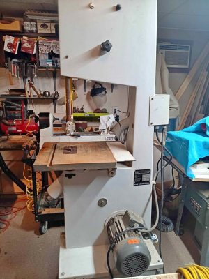

Well, I looked at it, it ran great, ran quiet, looked like the blade was running straight and the seller had dropped the asking price to $250, so I got it.

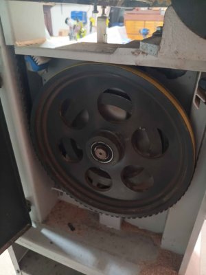

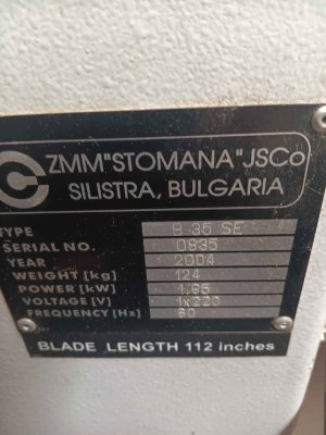

Overall, it's in good shape for a 21 year old bandsaw. There's a bit of sawdust buildup, the tension indicator doesn't work, there's some rust on the base (with enough in spots to flake the paint) and I feel itchy to take it apart, strip and repaint - but I'm trying not to give in to those tendencies. The seller turned out to be a great guy and we chatted about equipment and woodworking for more than an hour while getting the saw ready to transport. Took off the table, magnetic power switch and some components to lighten it as much as possible - but it's still a beast. Though I gotta say that when I saw it in person, it looked a bit smaller than I had imagined.
The seller bought it at an auction a few years ago and it sat in a barn for awhile until the table started to develop rust, then he brought it into his air conditioned shop where it's been taking up space and it was time to go. He did replace the tires recently so they're in great condition. While it has the wheel set from the factory, I'm thinking of replacing them with 2.5" double locking casters as there are four threaded holes in the bottom of the base. I think that would make it easier to move around just wondering if it might make it too narrow for balance (though it would be the same footprint as the base, so maybe I'm off in my presumption). Otherwise, it's time to treat the rust on the base, get it off the truck, clean it up, make a door and get it running.
@P_K - you said earlier that the blade looked like a Resaw King? Comparing it to the Resaw King on Laguna's website, the teeth profile looks a bit different - but I don't know bandsaw blade teeth profiles. Considering the cost of a new RK, it would be nice if it is an RK and can be resharpened.

That's defenitely a RK blade, just has the older geometry. https://www.rockler.com/laguna-tools-resaw-king-carbide-bandsaw-blade-1inch-carbide-blade
The teeth are carbide-tipped so they last quite a while, might still be sharp even though the blade itself is a bit oxidised.
