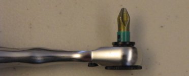

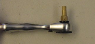

    I came across extra short 1/4" driver bits. They are from Snap On. And they have a set of them available. I got a T15 just to try out.  Fits into the Wera Mini Zyklop perfectly (actually snaps in place).  Some of the bits in the set have a higher shoulder so I am not sure all of them will lock into the Wera.  Total height in the Wera is 11/16" compared to a 1" bit at 1 1/16".  See pictures for comparison to 1" bits. And also shaves a little off the right angle if you need just a bit more room to fit somewhere.

Good find Seth...sometimes you need that little extra room. I find myself sometimes installing electrical boxes through the sidewall of the box rather than using the metal ears...the ears do add a lot of flex for certain installations. It's difficult to get a screw, regular length driver bit, 1/4" hex socket and ratchet wrench in the limited space at the same time.  [eek]

I have used the 1" bits in the Wera a few times where it fit and worked in the space. But a little extra would have been easier. Especially when trying to get a finger on the back side of the ratchet as well. Also will allow for a little longer screw.
