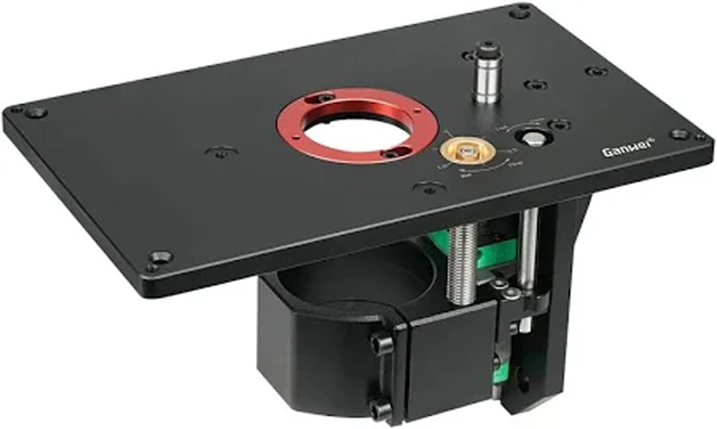

I have found a good router lift on Banggood together with a Katsu type corded router. The price and (assumed) quality work for me.

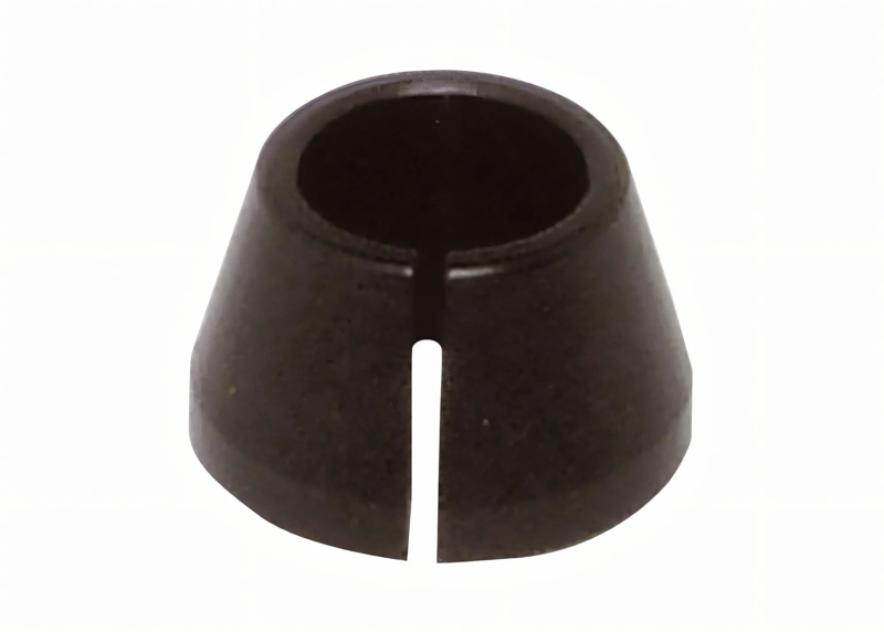

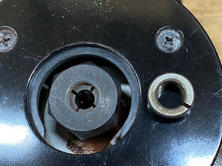

However my problem is that the chuck/collet on the router is 1/4" (6,35mm) and all my router bits are 6mm (majority) and (some) 8mm
I have no idea what kind of collets these Makita clones use or if there are 6mm aftermarket collets available.
Can anyone help with shared knowledge / experience?

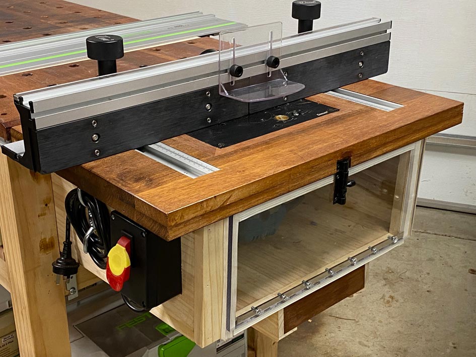

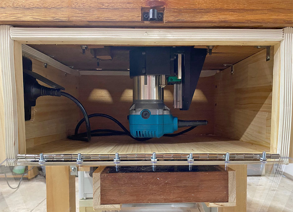

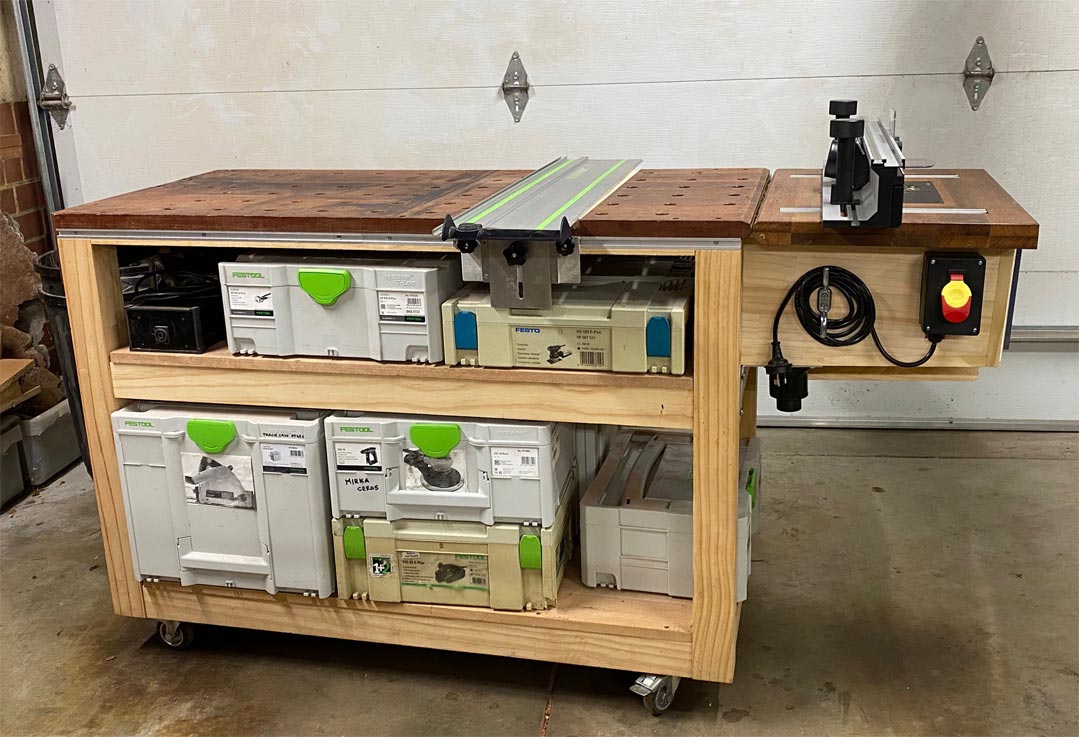

I have both the Katsu and a Makita original trim routers. They use the same collets. The Makita 8mm collet is my preferred choice as it offers about three times the stiffness of the 1/4" shaft. I also have a Chinese router lift for the Katsu. The Katsu is used in the router table at the end of a MFT. (I have a large 1/2" router table in my slider).
Thank you, Derek - very useful info! (y)
