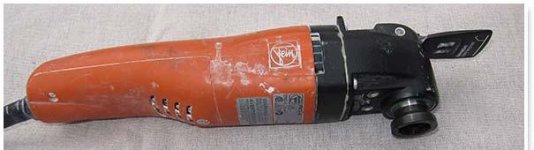

does this attachment fit the 250 ? i have soooo many of these blades and am reluctant to switch over and spend for the festool. the problem with getting the super cut is using the plunge with the venturo and using fein blades, is 1/2"away from the magnetic stabilizer.
Well, the attachment fits MM 250 and MM350, but, as far as MM 350 is in question, there will be about 2 mm gap between a Festool plunge base magnet and an installed blade surface. So... Yes it fits, but check how it sits.
