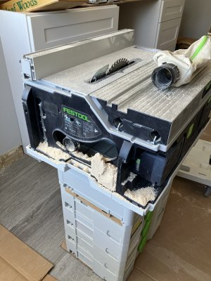

Hi
Working alone at 69 years old these days. No help to carry tools, clean up, and all that. l have lots of Makita tools but went to the green side for portability and dust collection over the last 10 years.
I get a call from my kitchen guy and one of his contractors bailed on a kitchen job and I was called in to finish up. Had to install about 30 feet of molding on top of 7 sections of upper cabinets. Had to make my cuts in the kitchen and promised everyone "it's festool so no dust". I also discovered I don't need my miter saw on small jobs anymore with the sliding table on the sys 50. After a few cuts on this kitchen job I noticed sawdust everywhere. Was using the bag as always and it was bad this time. I attached the vacuum and it was still throwing sawdust.
I remove one battery, slide the table, removed the access panel with the allen wrench and twisted the green tab to unlock the lower blade guard. Folded the guard down and it was full of wood slivers.
They were interfering with the airflow through the dust chute and blowing dust everywhere. should have seen me trying to line up a cut with the saw running and me with my face in a shower of dust, reminds me of the old days.
I'm mentioning this because this saw is different from other saws I have used. I cleaned out the lower guard and put it all back and no dust. Yea! As I was switching from ripping, crosscutting, and mitering, I noticed a sliver get sucked into the throat plate and dust flying out of the saw after the sliver went down. Cleaned it out again and no dust. So I'm not sure how to avoid slivers getting stuck but at least I know what to do when the saw starts to throw sawdust.

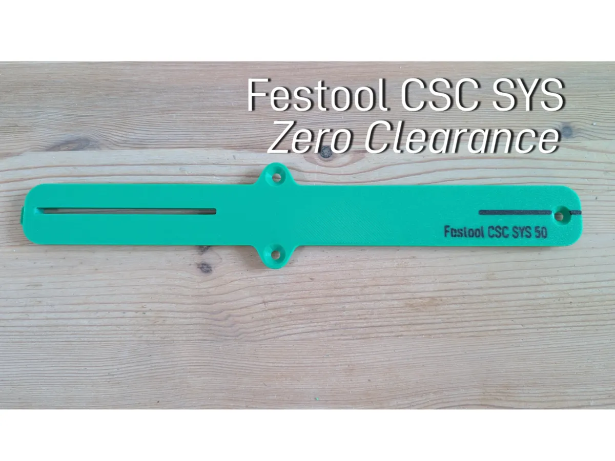

Is a zero clearance insert practical on this saw? That would keep all but the tiniest slivers from passing through to the dust chute.

A ZCI is definitely doable and would work well, I planned to model one ages ago but just never got around to it, I was hoping in the meantime someone else wasn't as lazy as me! ;-)
