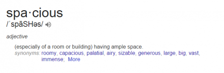

Large. And Spacious.  [poke]
RMW
RMW
spacious as  ;D
