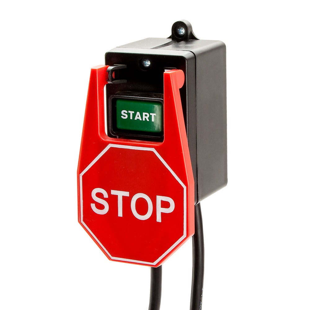

I did that, make a router table built into the extension.  I clamp a shop-made fence/dust collection device that clamps onto the saw’s fence for easy moving.  But I do have to fully lower the router bit to go back to using it as a table saw.
All together, not as convenient as I imagined, but still, I have it for about 10 years and it has not gone away.  It helps that my fence slides fore and aft so I can often move it around the router bit.  But not always.  So if my sequence of work has me bouncing back and forth between router table and table saw, it can be a nuisance.
But, still, I am disinclined to replace it.  If you go this route, make sure you use a machinery on/off switch with a large red paddle to stop the router.  Fishing around for the on/off switch can be either a hazard or make hazard avoidance an issue.
I have one like this:
