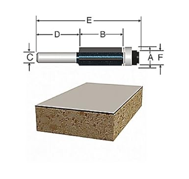

I use these ,
I like these as they are inexpensive , work as a template bit have "3" flutes , last a long time , cut very clean due to the added 3 flutes instead of 2

thanks for all the input!  I wound up going with the top bearing bit, I just like to see my whole "template" piece while doing the work.  I was aware of these types of bits and have used them before, I just thought that there was a way to do this with guide bushings without having to use an offset template.
Looking at the router bits with those bearings surely then there is no offset? Appears to me if you make your template final size, the bearing will follow and cut your new piece to same size as template so theres no offset required.
you are correct.  My issue is with using a template guide ring.  the pattern bits will duplicate exactly to your template, and i've had plenty of experience using them.  Using a guide ring, you have to make a template with a bigger hole than your final piece, which i didn't realize.
Aha, then simply don't use one, seems unnecessary in this case using those bearing type bits.
