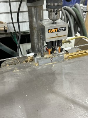

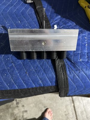

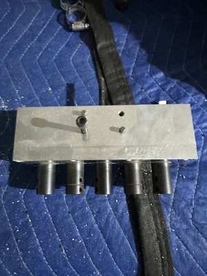

As I stated, I own both. The 5 spindle you posted must be installed on the base that the hinge boring head comes on. If the head was not installed on the base there would be nothing to keep it aligned to the fence or prevent the head from spinning.
Either can be used in a drill press or with a hand held drill. I find it takes more force to use the hinge boring head by hand due to the material we drill into (hard maple or oak primarily), than it takes to drill the pin holes into pre-finished maple plywood.
The picture of the rear of the head shows the alignment pin and one of the mounting bolts in place.
