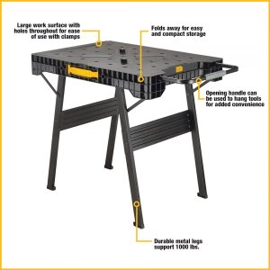

Peter, you need one of these.

I had a pair of Kelter tables. One of them self destructed. I have more faith in the pair of Dewalt tables I now have. But I suggest them mainly for how quick they are to deploy so you have a place to put the stuff that’s making your MFT unusable.
I actually own one of those for that same reason! I do wish it were more reasonably flat -to center is bowed in pretty noticeably. But great to put tools/systainers/etc.

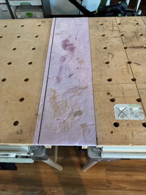

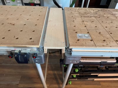

I have 3 MFTs and an STM 1800. My experience is that in my shop 900 square feet, three MFT's simply take up too much room. My current shop setup has two of them joined with one of three home made bridges. The one shown is 150mm, but I also built 500mm and 1000mm. After I built them I thought it night have been a good idea to make them the appropriate widths to maintain the 96 mm spacing of the holes, but never bothered. I have 1/2" pink foam that is easily replaceable and moved the track so it cuts on the foam instead of either one of the tables. This provides a full table to either side of the cut for material support.
I found that the 3rd MFT goes on site with me when needed as does the STM otherwise the 3rd MFT sits unused in the storage room. I've tried every configuration, U shaped, in a line, and long edge to long edge. I'm able to break down sheet goods in the shop on the STM, but have to move my ShopSmith out of the way to do so.
