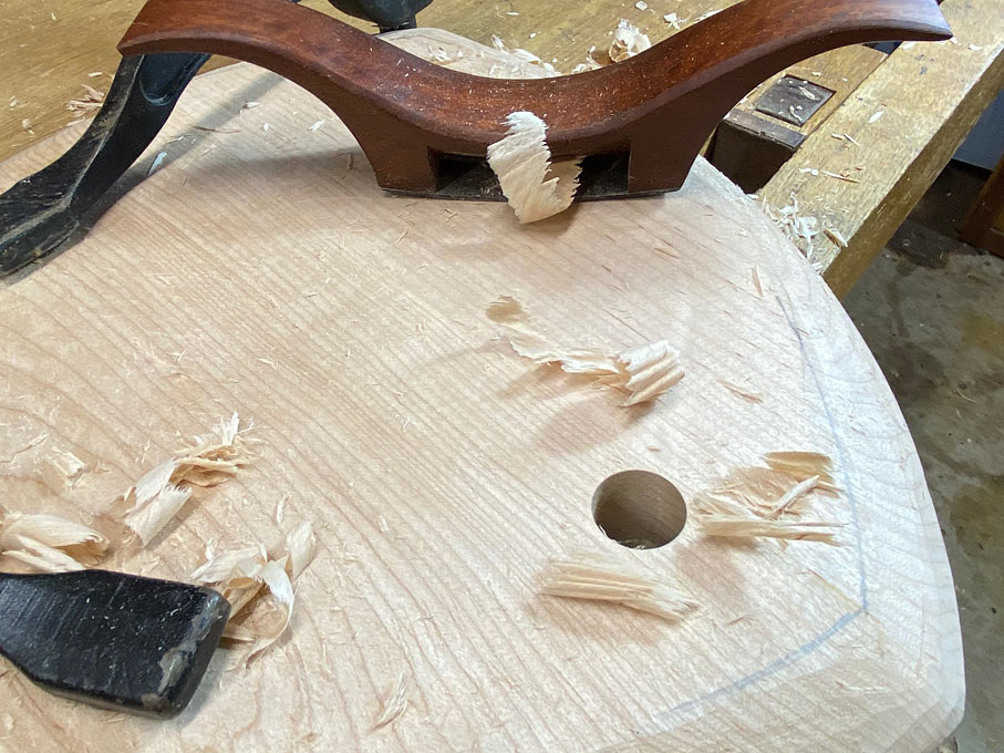

Past stools have used a scorp, pull shave and travishers to shape seats, and the legs were drilled with a brace and auger bit. Tenons and mortices were tapered with shop made reamers and tenon makers ...
For this build I decided to go a different route, and combine power and hand tools. One reason was that the wood chosen was Hard Maple, which is a little more work to excavate than, say, a softwood such as Radiata Pine.

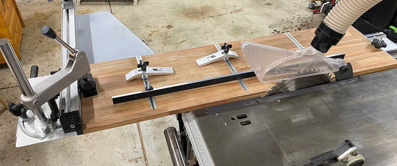

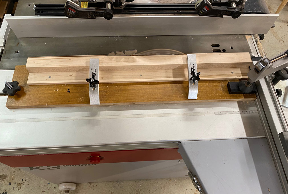

I made a simple fixture for production ripping the legs on the slider ...
Later, I built a version of this with an adjustable parallel guide fence. This will rip any width and also taper legs.

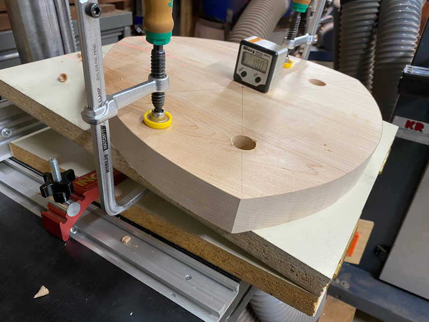

The plan was to drill the mortices on the drill press using a 24mm WoodOwl auger for this purpose (no leading screw). These are to be parallel-, not tapered mortices ...
The legs are a 10 degree rake and, being three legs and arranged around essentially a circle, the resultant angle is simply a line to the centre.
Not a lot of skill required here.

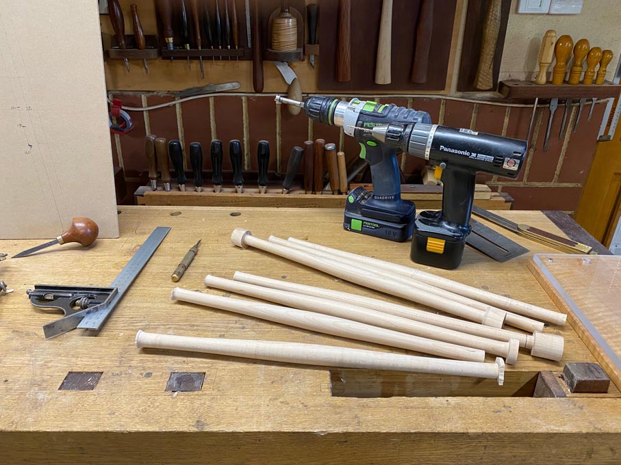

While at it, rough turned the legs ..
Finally, the hand tools take over. First it is the drawknife to rough out the tapers on the outside edges ...

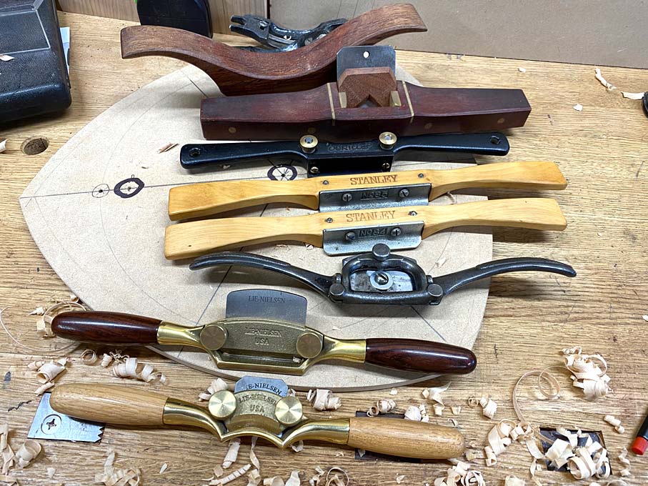

Then I had a fun time using different spokeshaves (I had not had a chance to use any in some months, so this was making up for lost time) ..
The Stanley #84 and #85 is an amazing shave (Jim, I believe that you gave me these). These work on the same principle as a travisher: the toe has a slight (2-3 degree) taper, which enables the depth of cut to be altered with the angle it is held to the work piece. The shaving done here is largely end grain, and the other shave to shine was the Veritas LA.

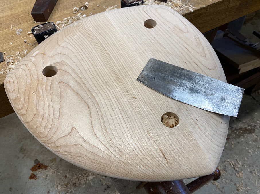

The hollowed seats were further shaped and smoothed with a travisher ...
Then back to shaves for shaping the sides. The HNT Gordon can shave into the grain, while the lower angle of the LN leaves a finer finish ...
I smoothed the surfaces with a scraper ...
... however Lynndy disapproved and wanted a sanded finish, which is how it ended.
There are a few gaps in the photos collected, such as the shaping of the legs. Not a lot here other than they taper from 25mm at the base, to 38mm at the swell, and then down to 30mm at the start of the tenon. The tenon is 24mm.

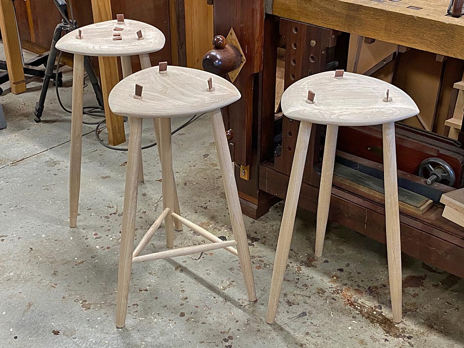

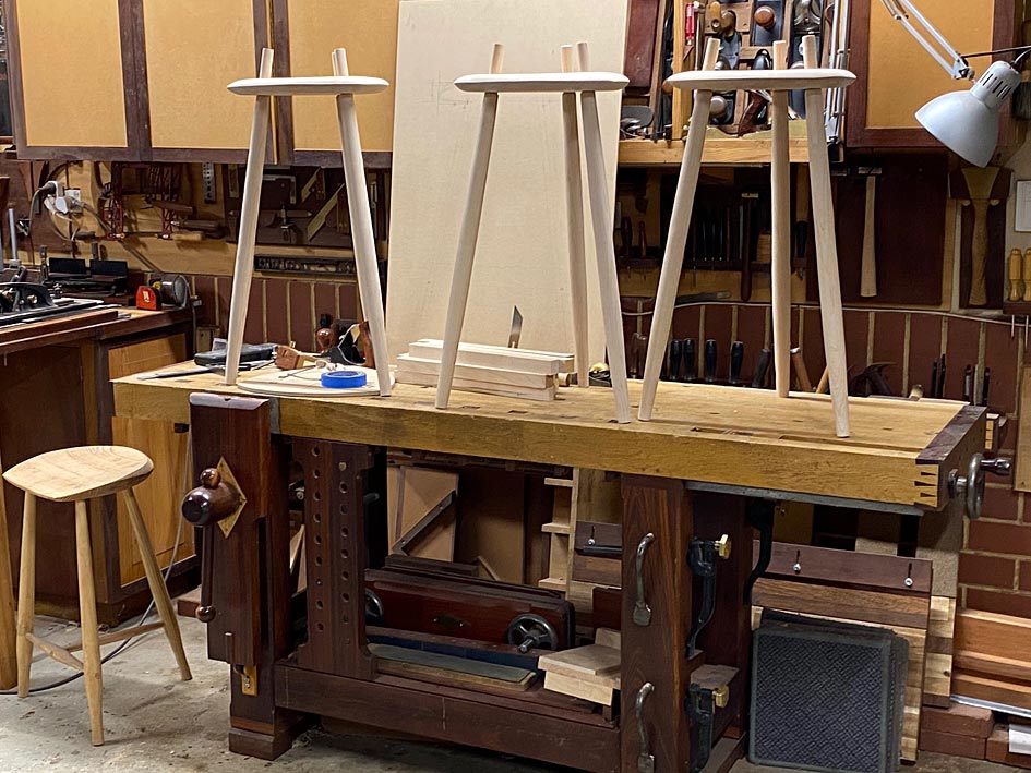

Here is a shot of the three stools with legs inserted ...
... and another with one set of stretchers in place ...

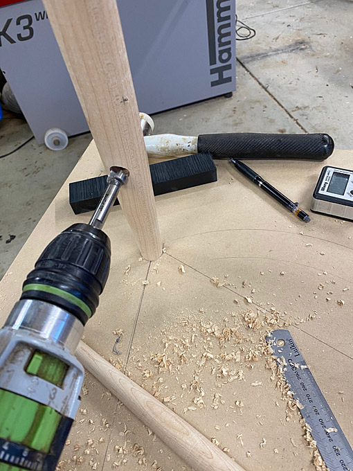

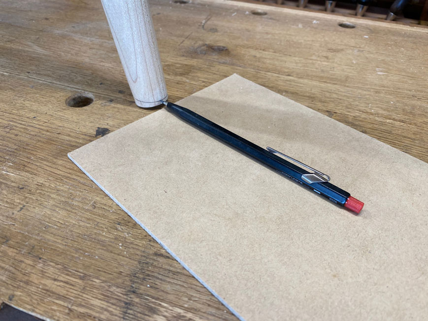

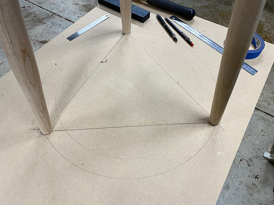

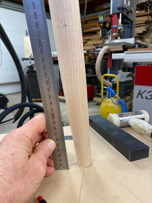

Firstly, I created a template for the positions of the legs, drawing these onto a sheet of MDF ...
The lines joining the legs provided a guide for drilling.
The height of the legs were marked. These were at 160mm, 190mm and 220mm. It is advisable to do these one set at a time, that is, drill the mortices, and insert the stretcher for one set of legs, then move to the next height. The reason: it is a little like fitting mitres - three corners are easy, but the last might require a little massaging. Insert the stretchers for two sets of legs, and then the last set can be marked accurately.

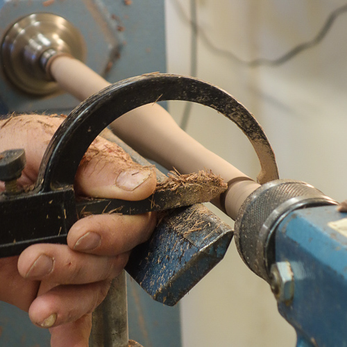

Once the mortices are drilled (halfway), then the stretchers are measured for length. The ends of the stretchers can be turned exactly to 5/8". A great tool for this is the Sorby Sizing Tool Set (photo from Elia Bizzarri) ...

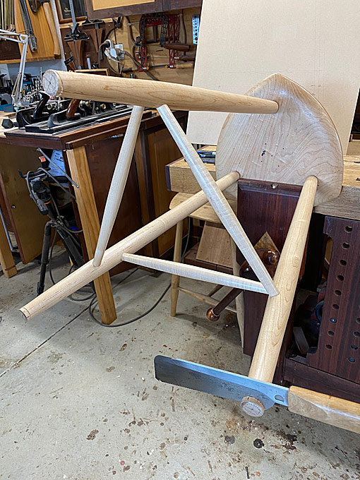

When glueing up, the stretchers-into-legs must be inserted first. Only then is it possible to do the leg tenons-into-seat mortices. Once the seat goes on, the structure is triangulated, and it becomes incredibly rigid. The stretchers would be impossibly be come out unless the seat is removed.
The last task is to level the legs ...
.. and saw them off ...
