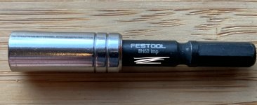

As said, and as you already know, the TID 18 has industry standard hex socket.
I’d do as SRSemenza suggests, just get an impact rated bit holder. The Centrotec stuff fits any std. hex bit holder - the bits itself from the installer kits are very standard bits.
In a pinch, Festool’s magnetic Centrotec bit holders are from a while back impact rated.
Se photo below, check if yours has the same inscription.
I really like the one(s) below, they have really strong magnets and keeps the bits well seated.
- Therefore these stay away from my impact drills …
