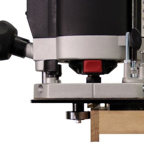

Do you have an auxiliary base for your Dewalt that can do thick edging?  Coupled with a bottom clearing bit after you cut close with a oscillating saw.
example of base type I'm talking about
My bad for repeating then.  I got confused and thought the horizontal milling base was in ref to the 0deg base.

It was in reference to the 0 degree base, and that's how I would do it. (with the wheel/follower)
The vertical milling, as shown in the video, works great, if you are out "in the field', but not on the edge like this case.
I used to run the set up along edges all the time, primarily to flush up window jambs. Don’t use the setup anymore because remodeling is not my primary line of work now.
