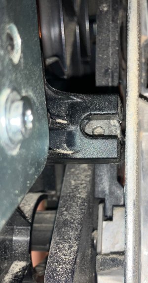

I am using a TKS 80 EBS that I got 2nd hand. Everything works fine except for the angular cut. The issue I see is that I can tilt the blade only to approximately 40 degrees + 2 degrees using the fine adjustment. I have already cleaned the endstop from saw dust which did not help. When I adjust the endstop at the rear of the fine adjustment with the set screw, I can tilt the blade to the full 45 degrees while it can still rotate freely but then I am unable to tilt it back to zero degrees. Instead I am hitting another endstop at around 4 degrees. Any advice on how to adjust this would be of great help. Many thanks in advance, Gero
Here's a picture of the endstop and the set screw.
