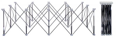

...but recommend a change in work technique. Instead of  laying foam panel on the floor, add a folding Centipede work surface, then add a MDF panel, under the foam board. You can use standard clamps. If cutting the middle of a 48 inch panel, you can use a step ladder and kneel on the panel. The manufacturer claims a 4,000 load factor so no danger of collapsing the table.
Your knees will thank you for not crawling on a concrete floor. These Centipedes table are frequently on sale and it provides a handy work surface for many other projects.  Tip it on its side and it springs together folding up nicely for setting in the corner out of the way.

I'm sorry but dude, ad mentioned above, I'd suggest simply changing your work habits.
At cheapest do the above, or get a cheap folding pair of saw horses ad a piece of mdf/osb/anything flat and yielding to a saw blade and work up at waist height.
I couldn't be paid enough to continually work that low down for the sake of my back and knees, and I believe you'd find the same once you find yourself a good method working up higher, plus hey, then you can clamp away to your heart's content!!!
I've got to agree with BigfòotBuilder,  bring the work piece up off the ground, you'll never look back! ☺
i already changed my work habit to this foam board on the floor and like it better than saw horses. i just pull the board out of my van and drop it straight down onto the foam board. don't have to muscle it up onto the saw horses that move around. after the first cut i'm generally resting my knees on the foam board which is comfortable. Don't have to hunch over the saw horses to make long cuts, just walk on the wood..
I'll look into these little stands though
I have two (the smaller size) from Lowe's. They are the most space-saving bench tops for assembly, cutting (including circle-cutting), nailing, layout etc., etc. Almost forgot the finishing table, too. When folded into the original bag, it takes up 10" x 10" space in a corner. Highly recommended if you have shop space issues for a permanent assembly table.
