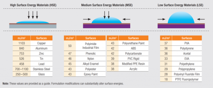

Buy a roll of 3M’s adhesive transfer tape.  It is like Scotch tape without the tape, just the adhesive.  You should be able to apply some extra adhesive.
Note:  Adhesive Transfer Tape is available in two basic types.  One that is applied with at “gun, which is really a tape dispenser, and the other that is applied by hand.  For this application, use the one that applies by hand.
There are also two (that I know of) strengths of adhesive available, regular and heavy duty.  You want the heavy duty for this application.
Once you have it, you will find endless uses.  But don’t apply it to wood that will become visible.  I have a very difficult time removing the adhesive.
There is also a tape made for applications to polypropylene, but it has a clear carrier. I’ve never tried it, but it looks interesting.
