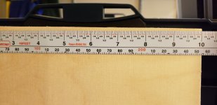

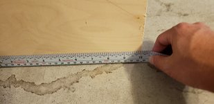

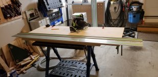

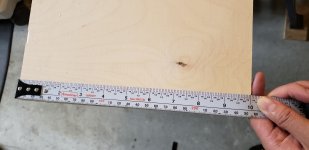

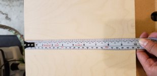

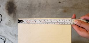

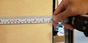

I was attempting to rip down a 10" x 5' piece of the plywood using my TS55 with a the blade that came with the saw.  I was using a brand new 75" rail that I had just cut the splinterguard prior to making my cut.
As you can see in the pictures the two end sections of the cut is pretty much right at 10", but the middle of the rip is something like 1/32" wider than either end.
I initially made my cut using the edge that was the cut with the panel saw from the store as my reference.  I was thinking that maybe, somehow their saw was off so I made another 10" rip using the factory edge.  This time it looks to be almost 1/8" wider in the middle.
I may actually be reversing which scenario resulted in the 1/8" difference, but in either case the middle of the cut does seem to be wider than either end.  Any ideas what could be causing this?

Well, don't rely on the factory edge or the panel saw to be straight.  Second, do you have a reference straight edge you can put along the raised profile on the track to check for straightness?  Make sure  the gibs are adjusted snug so the saw can't be moved sideways.  Even if that is properly done, you can introduce variations by shifting your grip or how you apply pressure to the handle, so try to remain consistent throughout the cut to minimize variations.
I forgot I should have probably trimmed off maybe 3/8" from either edge.  I'm just trying to make a clamp rack to hang on the wall so it actually doesn't matter if the cuts are even or square.
I have a 12" and 24" veritas straight edge, but they're rather short compared to a 75" track.  I also have a 30" stabila level, but I don't know that a level is quite the same thing as a straight edge.
I had said that the 75" track is "new" but it actually came with the reconditioned TS75 that I got from festoolrecon.com, so I guess the track could conceivably have been used also.  I did make sure that the saw base was tight to the track with no movement.  I also clamped the track to the plywood at both ends when I made my cut.  Hmm it could have been how I was pushing the saw - I admittedly did sort of speed up the push a little bit since it's just 3/4" sheet material.
I suppose I could retest with my TS75, but I'd really like to try to keep the remaining plywood in as large a piece as possible for a future project.

Using the level is fine to verify that the extrusion is indeed straight.  Even new extrusions have been reported to be somewhat wonky (I haven't experienced that myself).

Did you have enough support under the sheets so they didn't flex/bog down in the middle when you were running the track saw?
I usually run parallel support for long cuts along the cut line unless the sheets are small and then I cross brace them and make sure there is no flex at either end or in the middle before critical cuts.
It's either that or maybe if your tracksaw was not laterally adjusted to the track with them adjustment knobs so you had some play from side to side gouging out a wee bit more as you went along and could not keep parallel with the track with the baseplate due to lateral shift.
I was cutting on a piece of 2'x4' MDF.  The first cut was fully supported by the MDF (with the exception of the ends that were overhanging by ~6 on either side), but the second cut I made was actually skewed a bit on the MDF that maybe half or 3/4 of the end of the cut was not supported at all.  That could definitely be part of the problem that I hadn't considered at all - though the end of the cut still measured close to 10".
The track adjustment knobs were tight so there wasn't any play or wiggle on the track.

You can check straightness of the rail by putting it with the splinterguard edge against the edge of the piece that was just under it at the cut (flipping it over or turning it) - any error will double, should it not be straight you'll see it.
"...I was cutting on a piece of 2'x4' MDF.  The first cut was fully supported by the MDF (with the exception of the ends that were overhanging by ~6 on either side), but the second cut I made was actually skewed a bit on the MDF that maybe half or 3/4 of the end of the cut was not supported at all.  That could definitely be part of the problem that I hadn't considered at all - though the end of the cut still measured close to 10"...."
Ok, that isn't a large board - but was the MDF supported? And if so, by what? Laying out MDF between two sawhorses will not make them all that flat - especially running a track saw with a little pressure on. Unless supported length wise too they will deflect some during cutting. When I cut sensitive material like Corian/Staron I need to ensure the whole length is fully supported and straight with no flex before committing to the final cut.
"...The track adjustment knobs were tight so there wasn't any play or wiggle on the track...."
Ok, that's not it then.

[member=66216]GoingMyWay[/member]  Any luck sorting this out?
I hadn't had a chance to test the straightness of the rail yet. I won't be able to do that until next weekend at the earliest.
The MDF was sitting on top of 4 bench dogs on my Kreg table. I'd think that was supported enough. I didn't think I was pushing down that hard.
Let me know if you need a second rail to compare to.  [smile]
