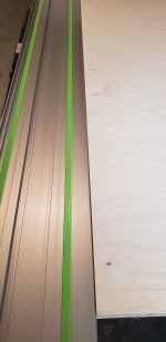

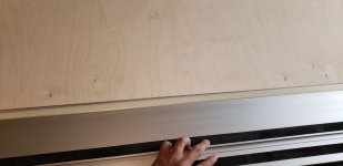

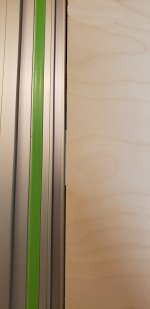

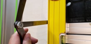

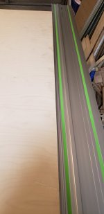

I finally got around to test the straightness of the guide rail. I may have done the testing incorrectly or what I have measured may be totally irrelevant, but nonetheless here is what I did:
The splinterguard appears to match up with the cut edge of the plywood.  It also appears to match up if I flip the guide rail upside down and place it against the cut edge.
When I tested the back of the guide rail against the cut edge there was quite a large gap.  The back of the guide rail appeared to be flush with the factory edge of the plywood.

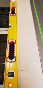

I also placed a 30" Stabila level against the middle of the cut edge and there was a .009" gap.
Well, plywood is not an inert material.  When cut sometimes internal stresses change and an edge can go a little banana-shaped.  For some work this is not an impediment and can generally be ignored.
I have an edgebanding press that requires quite straight cuts to do a good job, so I'm obliged to pay attention.  On long pieces of ply I want to band, I rip them a little oversized, let them move overnight if they want to and recut any edges that have gone wonky.
If you’re clamping a long rail at both ends to a bowed piece of plywood, then things will inevitably shift during the cut.
The board looked to be bowing “up” at the edges in the photo of your first cuts. If the straight rail is sitting on top of a concave board like this, then there will some space between the rail and the board as you reach the middle of the cut. The weight of the saw (and the not inconsiderable forces it’s exerting on the board) will force either the wood to conform, or the rail to conform, or the “far” clamp may shift slightly.
I don’t think the GRS-16 will help over these distances. Measuring a large 3-4-5 Pythagorean triangle will get you squarer. But “being square” won’t solve the “being straight” problem.
A flat floor with a well-supported board would be my first choice if it’s available. Or you could try clamping the rail to the ply AND something else that’s straight undeneath — effectively sandwiching the ply flat for the cut.
