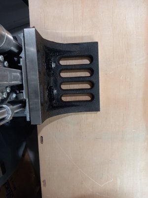

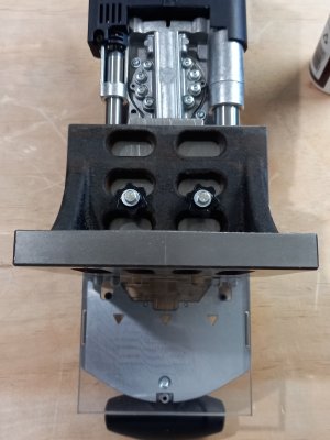

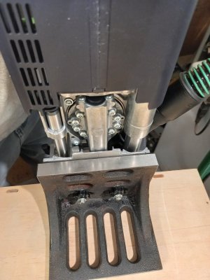

Very nicely done! Must have been fun lining that up perfectly on the mill?
Actually not as difficult as you might think. I set up an angle plate that has a side fence and is known to be very square. Align that to the main axis of tge mill. Indicate the spindle to centre line of the part. Then I set the spindle at zero for the plate that is holding the smaller plate. Claml it to the reference plate and cut away. Added a couple of support pillars to the outer corners for support and vibration dampening. Small manual mills take a lot longer that a cnc almost anything. I don't take pics normally of making things. Just the parts. It probably could have been held in a vice, but it becomes a lot of unsupported stock and would require something to cushion the cast finish etc. Becomes more of a pain to make it that way.
