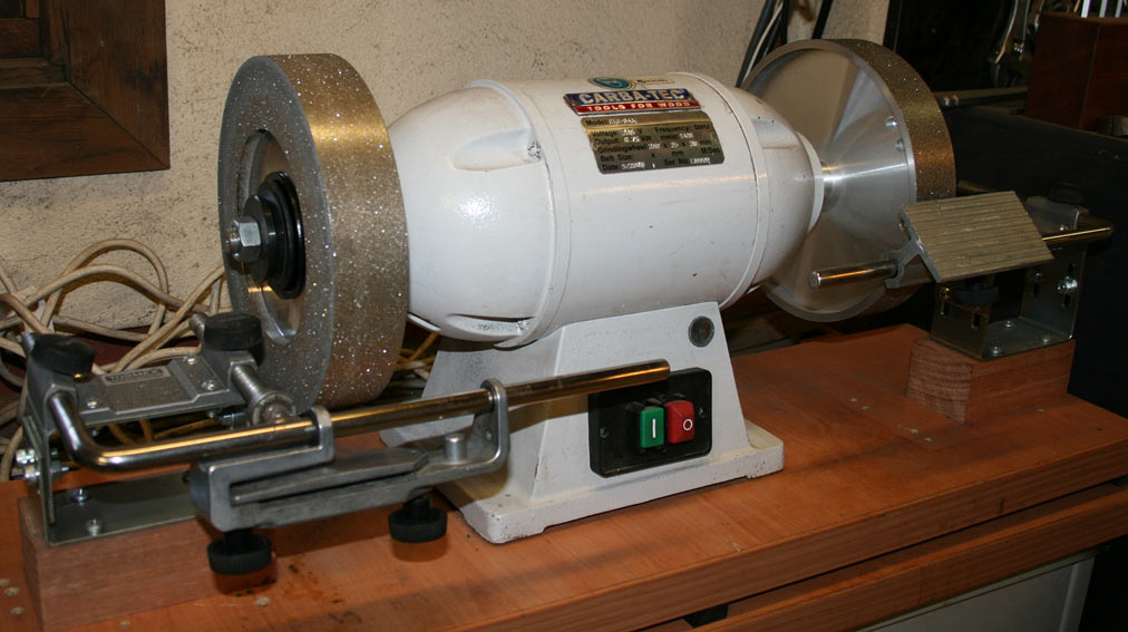

As mentioned, I like the tool rest a great deal, and have two BGM-100 versions on my bench grinder. These work with all lathe chisel accessories.
CBN wheels - no water needed. No wear = no need to re-adjust the angle jig for wheel wear .. as you need to on the Tormek.

I don’t turn enough to justify CBN wheels for my 8” slow speed grinder but for me the only reasonable choice is the Wolverine jig system with an 8” slow speed grinder with whatever upgraded grinder wheels you choose. It’s a great system, reasonably priced and very easy to set up and use.
