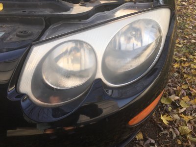

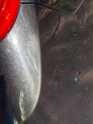

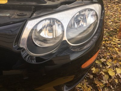

Unfortunately, the ETS EC will not give you the desired results because the pad will stop orbiting once pressure is applied to the sander. The good news is that any of the Rotexs will complete the task nicely. Here are some before & after examples on a 2012 Equinox using a RO 125. The last photo is an example of the hood when completed.

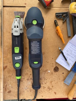

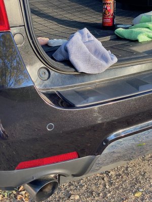

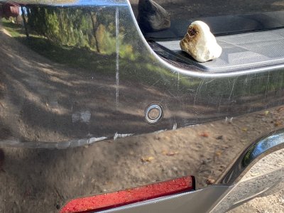

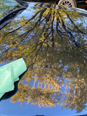

I would add that it depends on the condition of the paint and the desired result. I used my RO 90 to do some detailing on a car that had oxidization and fine scratches. I already owned the tool and bought the appropriate Festool interface pad. I did not have good luck and I tried many different compounds and foam pads from Griots Garage. I contacted their excellent support and was told it was likely due to the relatively small stroke of the RO 90. I was skeptical and bought one of their random orbital polishers and was truly amazed at the difference the longer stroke made. I cannot say enough about their knowledgeable support people. Good luck.

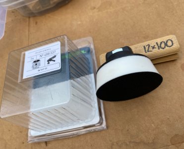

Just a thought - if you find that either the RO90/125/150 are beyond what you're willing to spend, you might consider the Bosch GET75. The Bosch comes in both a 5N and 6N version (5" or 6"). The GET75 is pretty much the Rotex equivalent at a lower price point.

I too have used an RO 90 for headlights. While it does have a smaller orbit, but it is well suited for the small pad. Some people say that they are difficult to use, jumpy and uncontrollable. It would be worse. with more orbit.

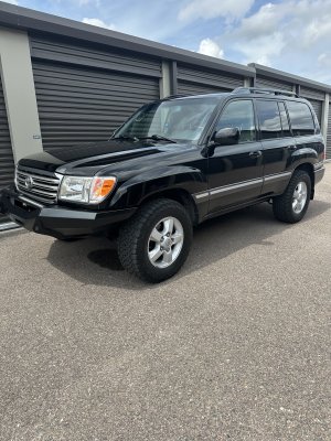

I completely buffed out a Chrysler 300M with the RO 125 so while that's possible, it led me to purchase a Shinex for the next vehicle. The Shinex normally uses a 150 mm pad but an 80 mm pad can also be fitted for those small difficult areas and a 180 mm pad is also available.
