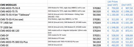

As I made "the sheet"; you know the one you make before purchasing tools to compare options between retailers. (sorry for being an engineer) I can share with you some of my research.
These are options available in The Netherlands incl and excl value added taxes.
The final option I went for is.
[list type=decimal]
[*]TS 55 REBQ incl 2 FS 1400/2 rails (491498), 2 connectors (482107) in one set (561580H)
[*]Extra 28 tooth Saw, 160x2.2x20 W28 (496302)
[*]Fast clamps DS-HZ160 (x2) (491594)
[*]CMS-TS-55-R No saw with angle stop in set (570281)
[*]Ron Paulk Total Station (modified, no Kapex) via his plans
