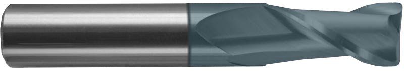

Ball end router bit or end mill.  Ball end router bits are available, I have at least four sizes.  Probably Freud but I'm sure lots of manufacturers have them.
