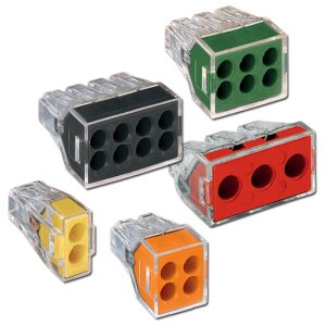

There is some movement of the wires with them. The 221 series are designed for both stranded and solid wire. The push-in types are only for solid wire.

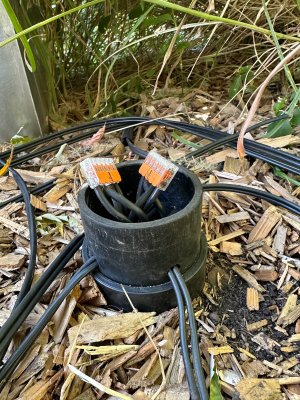

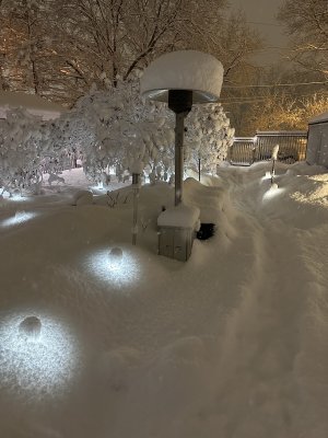

That's normal Rick as the wire is being held in 2 places, the bottom of the metal connector and the top of the connector spring. Every time I need to do any service on an outlet/switch/electrical box, I replace the wire nuts with Wago connectors. I've also used them for outdoor yard lighting of which I have 31 bollards, 22 fence lights and 7 other lit items...a lot of potential choke-point issues as the lights on the various electrical legs are daisy-chained. The original push-on style were installed 8 years ago while the newer lever style were installed 3 years ago.
Here are a couple of photos of the conditions in the winter that they have to survive. :D

That's normal Rick as the wire is being held in 2 places, the bottom of the metal connector and the top of the connector spring. Every time I need to do any service on an outlet/switch/electrical box, I replace the wire nuts with Wago connectors. I've also used them for outdoor yard lighting of which I have 31 bollards, 22 fence lights and 7 other lit items...a lot of potential choke-point issues as the various electrical legs are daisy-chained. The original push-on style were installed 8 years ago while the newer lever style were installed 3 years ago.
Thanks Cheese, appreciate the info and pictures. I hope to test some of my boxes today or tomorrow. Those outdoor light pictures drew me in too. Another thing I inherited on this house is a bunch of weird outdoor lighting scenarios. They are not on my radar right now but hopefully I can get some tips on that later on. Thanks for the info.
The best tips I can give you for outdoor lighting is to use wire designed for outdoor use and to tin every single connection. Most of these electrical runs were installed in 2007 and they still work every day...on a dusk-to-dawn sensor. Interestingly enough, I've gone through 3 Intermatic sensors in that period of time so the wiring methodology is more robust than the light sensor. :D All in all that's a good thing because replacing a single sensor is easier than replacing 8 electrical legs and over 150 electrical connections. 🙏

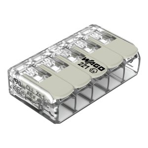

FWIW...the push-on Wago & Ideal connectors work well on solid coper wire but are difficult to remove because the individual wires have to be twisted back-and-forth to "walk" them out of the connector. Once the Wago/Ideal connector has 4 or more wires pushed into it, it's just about impossible to remove the wires. I found it easiest just to snip the wires, re-strip the wires and then use Wago 221 Series Lever Nuts.

Many years ago, I was wiring a large 150 unit apartment complex. We were given the push in Wagos and we had several issues with them in those units and returned to our usage of the “3M Electrical Spring Connectors” wire nuts as we went back and swapped them all out.

@Cheese I too use them in outdoor lighting, but I first pre-fill them with silicone based dielectric grease. This removes the need to tin any of the copper. The silicone grease prevents the oxidation and keeps moisture out.

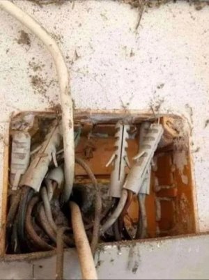

The guy who did that was likely on Mollies at the time...
For the non-US people, those plastic wall anchors are colloquially called Mollies as are ecstasy tablets (Mandies for you in the UK)
