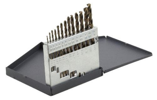

Machinist grade cobalt for metal is what I use and the
results are great.
