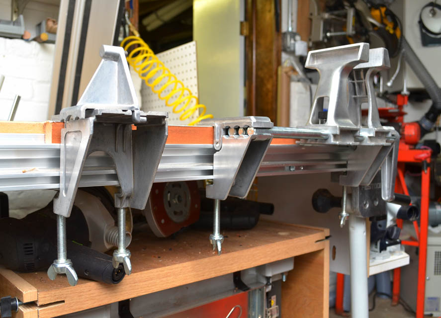

And although I haven't made a photo of it yet, I finally arranged a vise setup for the MFT/3.  It's a clone of the Zyliss clamp, with the advantage of the clone being that the mounting clamps are slightly wider than the Zyliss, so the clone mounts nicely on the aluminum rail.  I made an insert for the rail's "V" so the top of the vise is level with the table top.  I'll try to remember to make some photos of the setup today.  I have a Zyliss brand clamp that I also use on a 100 year old Christiansen workbench, and it's nice to have the interchangeable parts.

Here are a few photos of the Zyliss clone clamped to my MFT/3

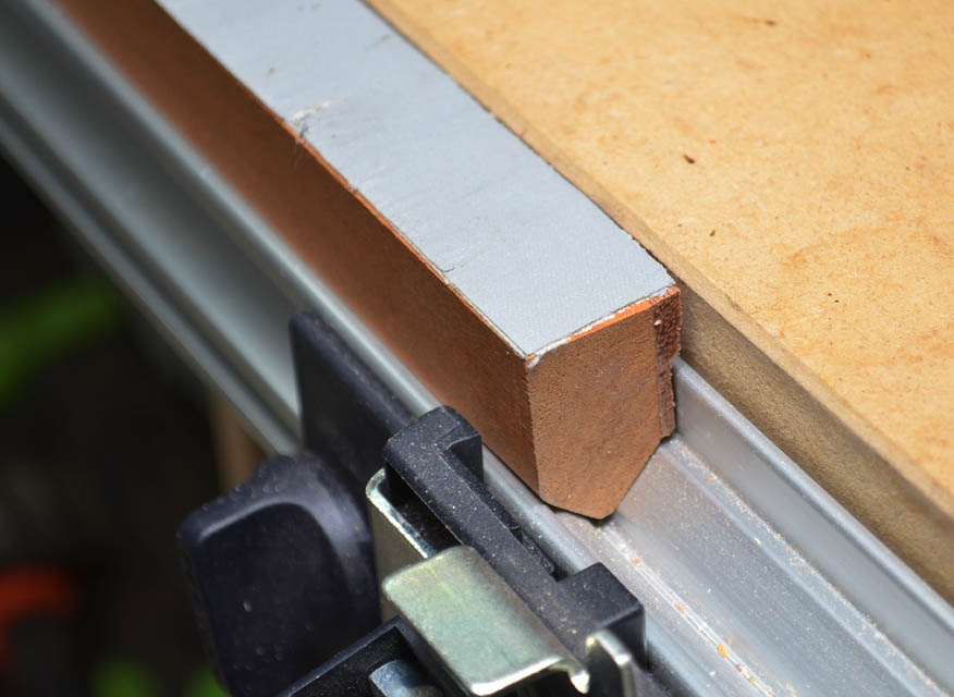

As you can see, I made two modified "V" wedges that sit in the aluminum channel of the table.  This brings the top of the wedges level with the top of the MFT, so the clamp mounts treat it as a level top.  This facilitates many of the nice features of the clamping setup.

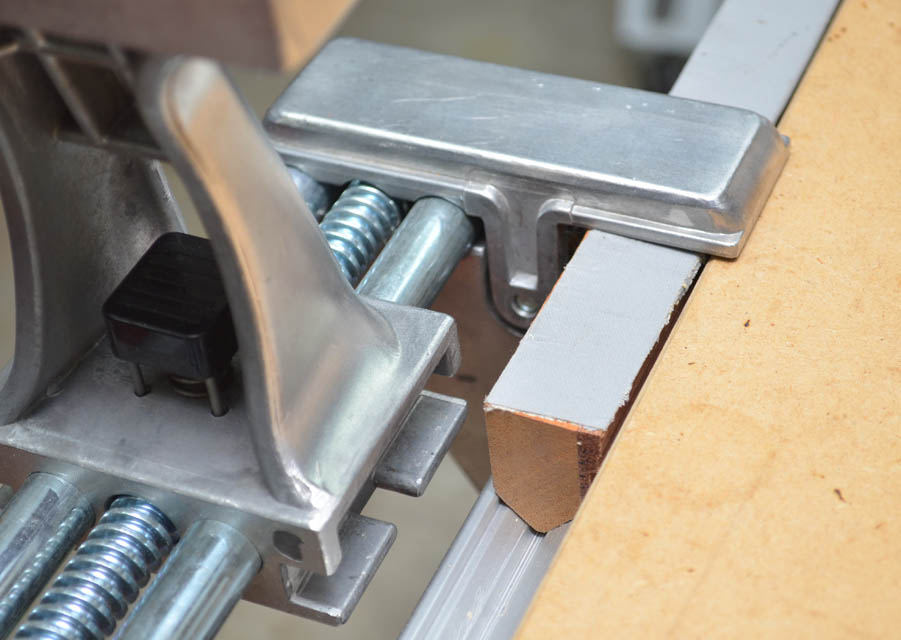

As mentioned, the OEM Zyliss clamps mounts don't fit as they are shorter than the clone's mounts (in the photo, the Zyliss brand is the one on the right)
So, I use the Zyliss brand clamp on another work bench and am just starting to use the clone (which accepts all of the Zyliss parts) on the MFT/3.  I'm just starting to explore using some of this systems clamping options... it's a pretty versatile rig.
I hope this gives folk some ideas for additional clamping on the MFT/3.  The trick is finding a clone with wide clamps.  I lucked out... I was in a store and they had found this in their warehouse and just wanted to get rid of it.  Price for the clone (with all the accessories): $25.   Couldn't pass that up!

I missed uploading the photo of the clone vs the OEM Zyliss mounting clamps... now you should be able to see the difference (Zyliss on the right).
