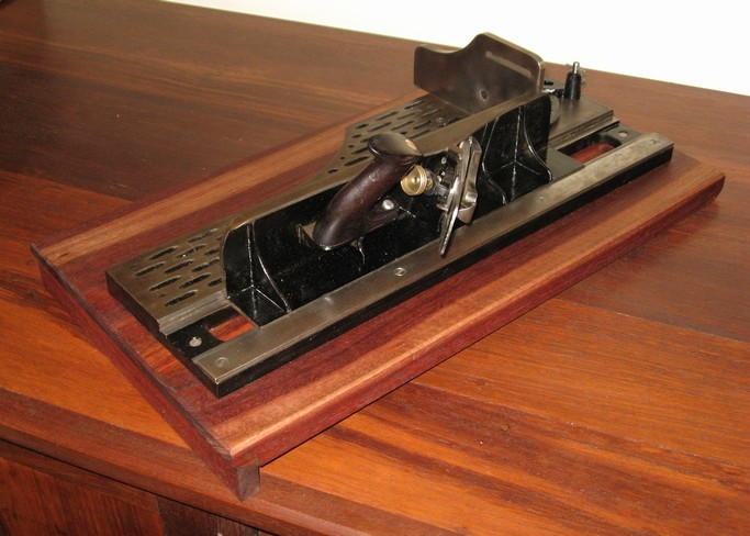

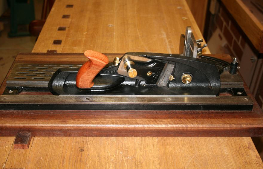

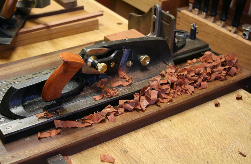

The “best” shooting board is the Stanley #52. Here is it with the Stanley #51, which was the model for the Veritas Shooting Plane and the LN #51 ...
I have used it with both these planes, and it is sublime. Here with the Veritas ...
The #52 is 120 years old and difficult/Expensive to find. LN began making one and then stopped. The track and fence offered by Lee Valley/Veritas is a the next alternative (I have not used one).

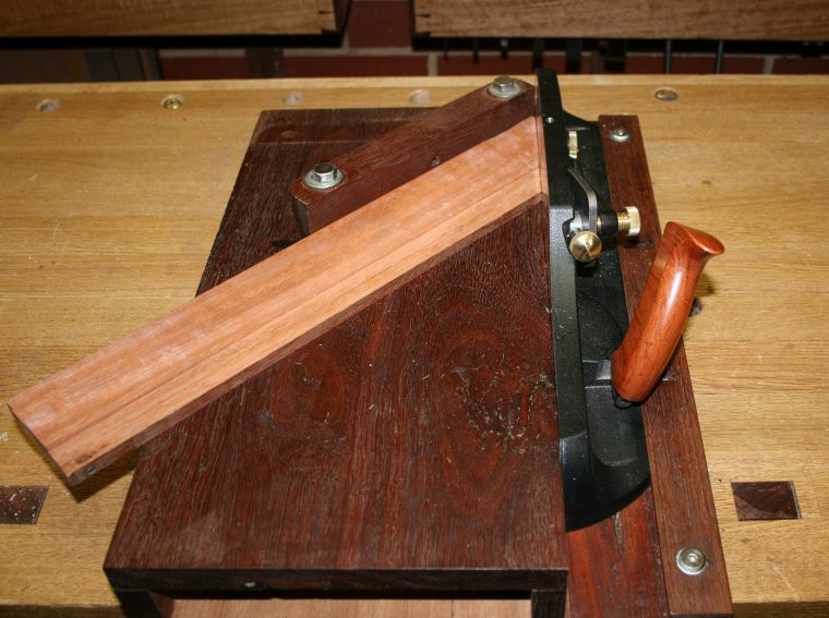

In regard to a shooting board, I was posting designs on the Internet for building ramped boards long before anyone else. The original Tico Vogt ramped board was a copy of one of mine. Since then they have evolved.
Here is the last design I made ..
Now, here’s the thing: you do not need a ramped shooting board for a shooting plane with a 20-degree skewed blade, as with the Veritas and LN. The ramp is designed for planes with squared blades. So, build a flat shooting board, either using these features, or build one around the Veritas track.
