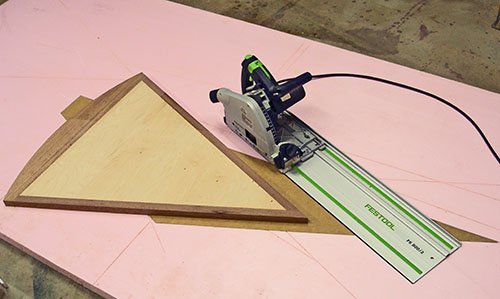

I plan on doing some Festool Plunge Saw Cutting soon and was wondering which do you prefer as the sacrificial cutting
material under the project plywood?
For this discussion, let's assume that I do not have an MFT or I do not want to cut into the top.
I saw 2" 4 x 8 foam (~$25) and 3/4" 4 x 8 MDF (~$24) at a local big box store, basically a wash for cost.
Please comment, Thanks in advance.

I love using the foam.  Light weight, long lived.

I have used a 2" insul board on my assembly table for two years ( or more) .  I split the board in half lengthwise, to form (2) 2 x 8 sections, then taped the back together to form a hinge of sorts.  When I'm not using the foam backer, it easily folds and packs away into a nook in the wall.
I like 2" board because it's still quite rigid, and ok for occasional use on sawhorses, and much more maneuverable than mdf.

I prefer the 2 inch pink foam. It holds together and can support weight while cutting.
I have been using 1" foil faced sheets for the last 200 cuts or so. Set saw depth of cut to cut 1/4" into foam. Cuts on top and bottom are perfect. To me this setup is so good, I havent stopped to consider other materials. I like the 2" pink boards with the tape hinge...that I will try.

Dust extraction with foam underneath makes a world of difference it becomes about 95% (this includes tape over the disk change port).

Not only does it improve dust collection, it also gives a cleaner cut on the back-side of the panel. A sacrificial cutting substrate is a win-win situation; be it foam, MFT top, or the next sheet(if perfectly measured and aligned).
