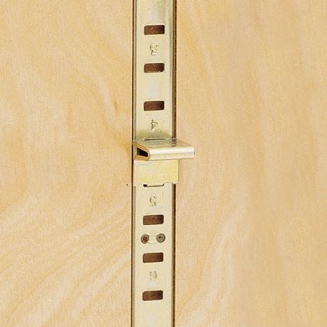

Why have these brackets fallen into disfavor?
Packard
Nov 6, 2020
4,821
Hudson Valley, NY
I used to use them for all my cabinets.  I typically cut a shallow dado so they would sit flush.
They were faster and easier to install than drilling holes.
They are stronger and longer lasting.
Retrofitting in a cabinet with worn holes is quick and easy.
So, why?  I am thinking of going back to this type of hanger bracket.
I think there are trade offs.
        In my case the two are about the same when it comes to installation time. But I am low volume. I can probably do holes faster than the metal standards.
      For open cabinets and shelving many don't like the look of the metal standards.
      For closed cabinets it may really depend on the production set up. If using the 32mm system then the metal standards  depart from that.
      I do like the 1/2" spacing. I do tend to use them for some utility shelving and cabinets. But overall anything that is visible I go with the 5mm holes. And in my case the holes are just as fast if not faster.
Seth
Like Seth mentioned, I think it's mostly appearance based. I've used both in the past but now gravitate towards the holes only approach. I've also had issues with removing the shelf clip and repositioning it. Sometimes that clip needs to be slightly compressed with a pliers which can become a body positioning issue if the cabinet is very deep.
I'm going to agree with the others.  Appearance.  Inside of a cabinet with the door closed, it doesn't matter much since you can't see anything.  But on open shelves, you are always looking at the silver metal brackets.  And even with cabinets with doors, once you open the door, you instantly see a silver metal bracket on both sides.  Then you wonder, why did I even bother to smooth and stain the interior of the cabinet if I see these silver metal brackets standing out?  Why did I even bother making pretty wood cabinets?  Would have been easier and quicker to just go down to the tool store and buy some metal toolbox cabinets.  Make a whole kitchen with tool cabinets.  You could just roll the cabinets out of the house when moving.  Not even unload them.  Just like in Europe where they take their kitchen cabinets with them when selling a house.  For utility purposes, the metal brackets look fine and work great.  Use them.  But if you want something to look nice and professional, then no.
Believe it or not, we do still use them occasionally in the cabinet shop, though I don't remember seeing any lately? Maybe a change of architects?
For production shops, installing them is quick and easy. The CNC can make the grooves as it is cutting out the parts and they actually get stapled in place. "Someone" makes a nose piece that attaches to the face of a specific Porter-Cable stapler, I'm not sure that it is actually Porter-Cable? It has a little probe on the front of the mechanism that fits into the slot  adjacent to the two little holes in the shelf tracks themselves. Many people don't even know that is the purpose of those holes, since they screw them on in the provided holes for that.
I think they are mostly thought of as heavier duty, mostly used on deeper cabinets, but not always.
I have seen them in 12" deep uppers too.
We used to have this nifty guillotine that was designed to cut them quick and easy too, aluminum or steel.
Whoever mounted the ones in the pic, missed the numbers? Thay are upside down.
