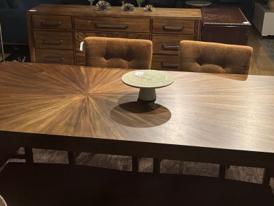

On vacation last month I saw this table through a store window while waiting to be seated at a restaurant next door. It was after hours and I couldn't go in and look at, it but was struck by how beautiful it was. I can envision a process (very tedious) to cut, glue and clamp the pieces to render the table top but am completely in the dark as to whether wood movement in the wedge shaped components would be a big issue. I guess it could also be parquetry or high end veered ply, but from outside the window it looked like hardwood.
Appears to be walnut, guessing grain orientation would be a consideration but all in all the construction nuances are above my pay grade.
Anyone have insight or care to comment??

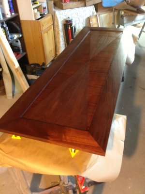

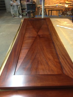

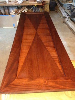

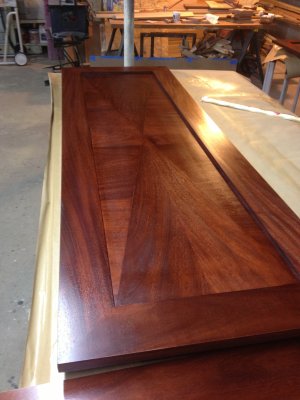

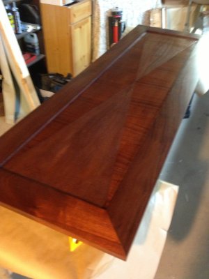

Done similar on a pair of doors. As mentioned a stabile substrate is necessary.
The material is sapele.
