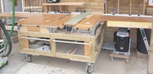

An OF1010 router and a big MFT/3 is brilliant for dados and rebates in sheet materials. Lots of flag stops on the MFT/3 make making bookshelves and cabinets etc. very quick and easy, accurate and repeatable.
