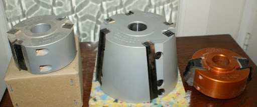

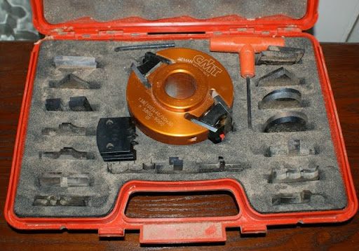

Below are a couple of pics of limited cutter blocks and a selection of cutters to fit the CMT block that needs two cutting knives and two limiting (dull) knives. That I own and use.
Rob.
