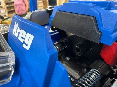

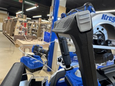

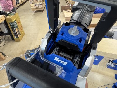

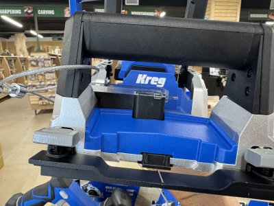

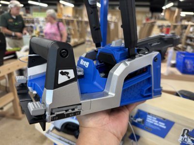

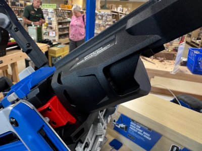

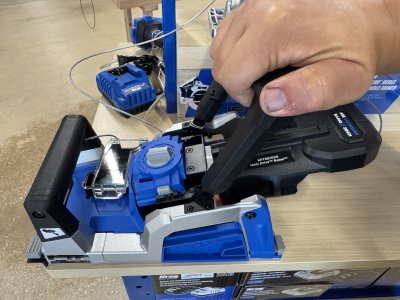

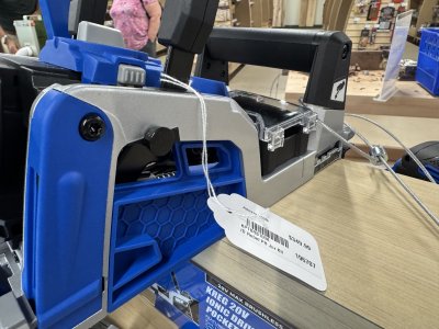

Was back at my local Woodcraft today and they had finished setting up the Kreg Ionic display. Pretty hard push on both Kreg and Woodcraft's part and the display is right in the center of the shop.
I got to handle them all, put a battery in them and turn them on (don't know if I'm really allowed to do that, but I did). I said before that I they looked like they would fit in somewhere between Kobalt and Craftsman and I still think that. Overall, they seem like perfectly serviceable tools that are clad in Kreg's typical blue plastic casings. Outside of that, I didn't find anything that remarkable about the lineup. Doing the All The Power In The Universe Test with the impact driver - that was ho hum. The drill felt like it had more oomph when you pulled the trigger. The sander reminds me of Ryobi's 18v Cordless Sander in design. It does have switchable speeds. The mini jigsaw is about the same size as Skil's 12v version but the plastic casing feels cheap.
What I thought looked interesting in the 731 Woodworks video last week was the trim router. In person, it is a cordless clone of the Makita 701 corded router - and being offered at the same price: $149. While I have the Makita and it's a good router, the height adjustment sucks. The Kreg keeps it and that sucks too. There was really no improvement on the design. A far better deal is the Hercules trim router for $70 which has superior height adjustment.
And then there's THE DOMINO KILLER.
Three hundred fifty bucks of pocket hole rebellion. You've seen above how it comes apart to switch out the driver. It's got some metal and a lot of plastic. I don't know what it is but Kreg's plastic always feels... "cheap"? No, not "cheap" but a little better than cheap. Fine on a $20 pocket hole jig that you clamp to the workpiece but on larger power tools at a price (I can get the DeWalt 620 router for the same money). Battery mount is on the back and goes in from the side (a little odd) but it's not quite apparent how to turn it on - where's the switch??? It took me a few moments of futzing with it to realize the big handle has a lock to depress on either side then a bar to pull on the underside of the handle, like a trigger. It's not bad. However there's a pointed lip on the handle that digs into my handle. Uncomfortable. Makes me wonder if I'm supposed to palm the handle and that curve is supposed to guide me? Tried it that way and the tool is more difficult to operate.
Maybe I'm thinking too much like a Domino user. Once I figured it sits on the workpiece and the front fence registers off the side of the piece so the tool lays flat, it seemed alright. There are some skid pads on the bottom for grip and it seemed fine as a tool. I'm not much of a pocket jigger so it's utility for me is questionable. However, the woodworker who uses a lot of pocket holes will probably find this to be a Godsend or maybe "The Tool That Will Change Woodworking FOREVER!!!"

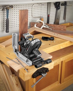

I bought, a number of years ago, a Porter-Cable version of a stationary pocket hole jig. It is big, heavy and entirely made of metal. P-C abandoned the product after just a few years. It is well-engineered and works perfectly. And it suits my metal-is-better mentality.

Here is the P-C jig:

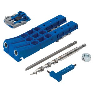

And this is the jig I bought for the longer pieces:
I have the sub $20 Massca twin jig for normal pocket holes, and a now-discontinued Kreg KJHD Jig HD for large (2X material) pocket holes. The latter has been replaced by the Kreg KPHJ920 Pocket-Hole Jig XL, but the newer jig would not have worked for my application, which was reinforcing re-drawing together a toe-nailed joint of horizontal 2x8s into vertical 4x4s. With the old style jig I could just butt it up at the joint and drill holes, but it looks to me that the new jig would have required taking the joint apart to fit over the 2x material's end. That would have been virtually impossible since my 2x8's have vertical grape stakes attached to them and spreading that joint apart would be a major issue, if even possible without damaging the fence further.

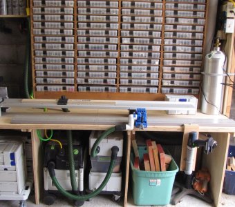

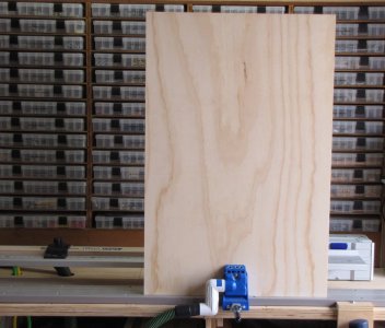

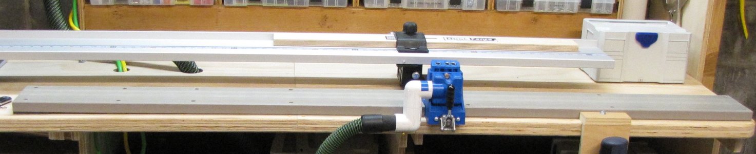

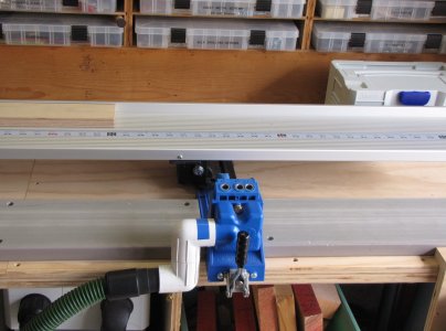

I have the earlier version of the Kreg front handle unit K3, I think. I set it up in a permanent location with long side supports and a drill "holster" made from PVC conduit. Use the PDC for drilling holes. Because I have the long supports it is easy to stand some pretty big panels on it. The vac suction through the DC port even helps hold the piece upright while I hit the clamp handle. It's positioned to make use of the space in front of the miter saw fence / extensions. The pocket hole jig material supports are made from some left over gray Trex.
I can drill them really fast with this set up. Partly because it is easy to slide the panels along. I don't lift it out between holes. Drilling with one hand working the clamp and sliding the panel with the other. Start at one end, drill, unclamp, slide, clamp drill, repeat.
But for really large pieces that new unit will be great compared to fiddling with clamps etc.
